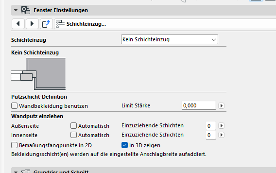

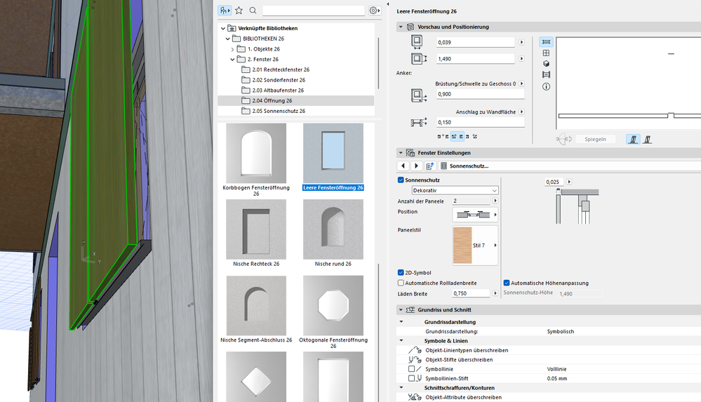

I would like to make Sunshades right next to the wall, but I don´t find the setting to reduce the distance between the wall and the sunshades.

The casing thickness will offset the shutters.
Any reason you are using a separate opening with shades rather than just using the ones in the window?

Thank you.
Somehow it does not change with the casing thickness. I set all to zero.
But it might be an issue as I am placing multiple empty windows one over another.
I do that in order to be able to export different settings to a rendering software (Sunshades are seperate for example).
