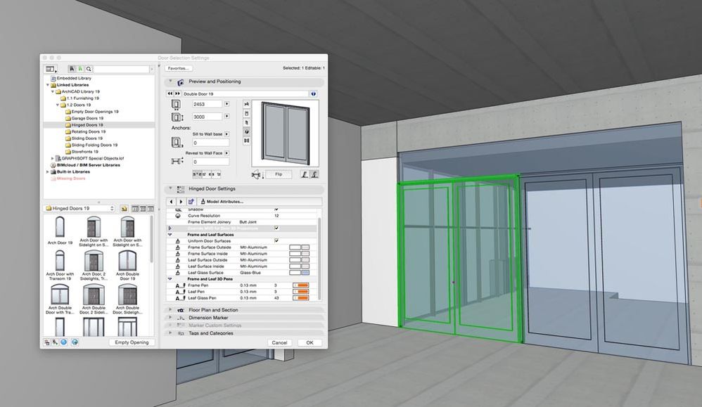

I have a double door in archicad (actually all the doors in my project) is misbehaving with regards to their surface materials. As you can see in the screen shot the doors show in glass all over. however in the setting the frame is set to aluminium, and the glazing to glass. I have not work with the renovation filter so it is not that. I can not see any setting where the surface can be override like this. Is this a bug or a setting I am missing?

You have Uniform Door Surfaces checked. What happens if you change the Leaf Glass Surface material?
