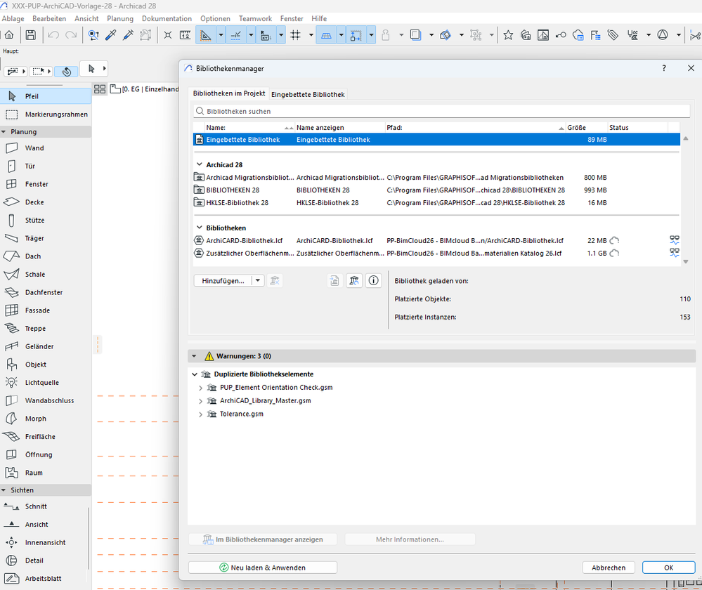

I've been working further on migrating to Archicad 28 and I have one question:

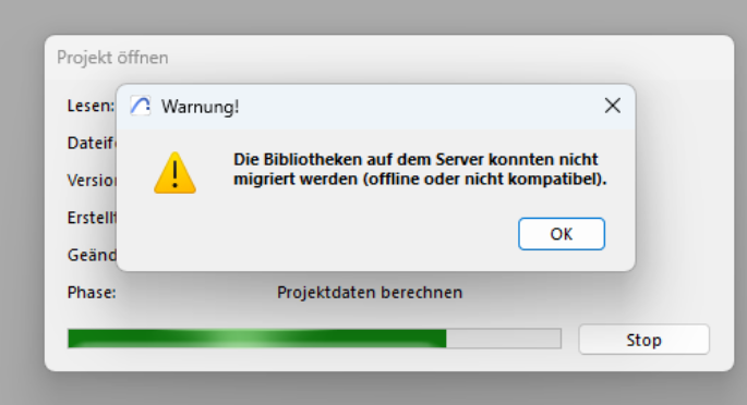

I read that libraries should be migrated automatically. So I downloaded an Archicad file from our Archicad 26 BIMcloud and opened it locally in Archicad 28. When I did that, I got a warning message – but after clicking "Continue," it seemed like all libraries were there.

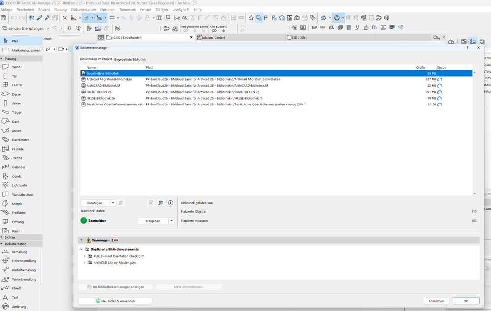

Here’s what the Library Manager looks like in the 26 BIMcloud version:
And here’s the Library Manager in Archicad 28:
So... it looks like the library was still migrated, right?
When I check the warnings, the only one that comes up is about Tolerance.gsm, which I assume is normal.
I then uploaded the file to the BIMcloud 28, and the libraries show up correctly there too.
I just want to double-check – is it safe to say nothing is missing? I am surprised where did Archicad find the whole Archicad Embedded Bibliotek as that includes a lot of random printscreans people uploud from their personal computers.

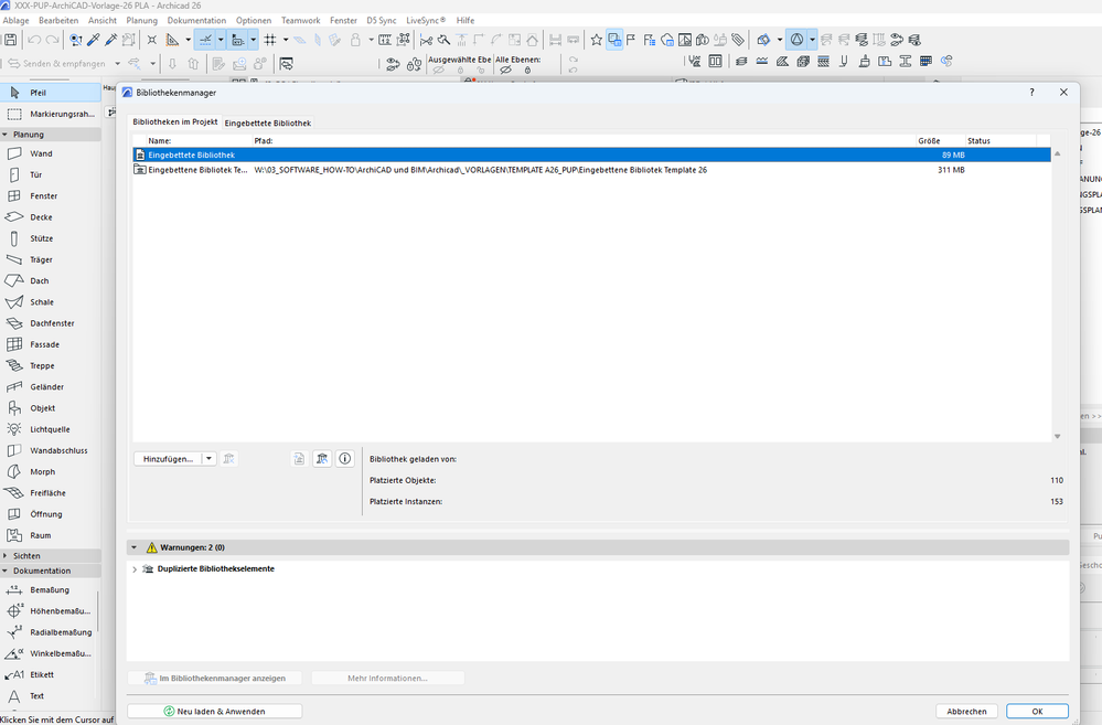

I also tried saving the Archicad 26 file as a PLA and then opened it in Archicad 28 — but in that case, the whole library gets saved somewhere on the disk, and it doesn’t seem to migrate to 28 properly (which I assume is not ideal?). Many of the Archicad 26 objects stay as Archicad 26 versions, and I guess it would be better if they were converted into Archicad 28 objects instead?
So I’m a bit confused about the correct way to migrate a project from Archicad 26 to 28 and for sure keep the whole library

Archicad Library 28 is actually the 27 monolith library.
If you have this library loaded, you do not need to load the 26 library as well.
You only need one complete library - either 26 or 28.
If anything you just need the migration libraries loaded as well as 28.
The Archicad 28 (27) monolith library is not the same as the 28 Global Libraries (library packs).
There is no migration to the 28 Global libraries from older libraries - it is a completely new system.
So load what they call the 'Archicad Library 28' as well as the migration libraries.
