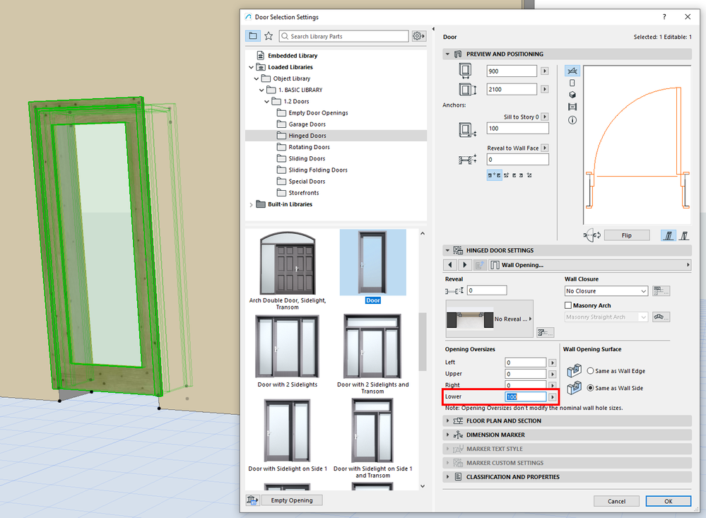

How can I keep the door’s wallhole and the Sill to Wall Base setting at 0 mm while positioning only the door unit 100 mm higher at the finished tile level?
2 hours ago
Is this what you re looking for? It can be achieved by setting the Lower Oversize to 100.
However, the Sill to Wall Base value will be 100.
