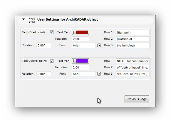

Arrow object - one end an arrow, the other a circle?
rob2218
looking for an object, pline, whatever you can muster that can function in the folllowing manner:
1. should have the ability to have an "arrow head" on one end.
2. should have the ability to have a "circle" on the other end.
3. can add custom text to either end.
we need this object for the stair path of travel.
we can seem to get the stairs to show the correct "UP" or "DWN" on the specific floors we need them to so we are having to shut down the text on the stair objects and just put a simple path of travel (arrow on one end and circle on the other).....

Done. It“s on Objects Depository:
Name.....Freccia zig 14. Look at upload history....05/2013 or in
Depository/01 General/ Graphic Symbols/Freccia zig 14.gsm

how did you get your "text2" and "text3" to space properly?
my text comes out on top of each other?.....other than that...it's awesome guys..really.

This error is for US units only. Now I fixed it (row text spacing is correct for Metric and US units, regardless on Scale used).
Download the last version of the object.

Roberto, yes I receive it. Thank you for yor suggestions.
Done that changes + add stretchable hotspot on start point and add UI for Start and Arrival points. Object will be added into Depository soon.
