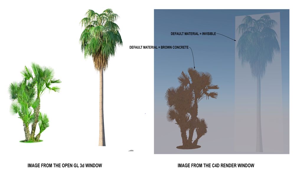

So... I created an EASY object to tip a PICTURE up and face camera...
This is the ENTIRE 3d SCRIPT
Rotz (90-ATN((SYMB_POS_X-GLOB_EYEPOS_X)/(SYMB_POS_Y-GLOB_EYEPOS_Y)))+(90-SYMB_ROTANGLE)
hotspot 0,0,0
hotspot -a/2,0,0
hotspot -a/2,0,zzyzx
Hotspot a/2,0,zzyzx
hotspot a/2,0,0
hotspot 0,0,zzyzx/2
Rotx 90
addx -a/2
picture gs_picture_name, a,zzyzx,1+0
It does NOT consider MIRRORING.. I just need it to work for now...
Works like a champ.. Even builds it's own LIST OF AVAILABLE jpg's in a pull down menu if you use the "gs_picture_name" parameter.
But... when you go to C4D rendering.. the DEFAULT material for the object get's used instead of the PICTURE in the picture command..
Funny thing is that it maintains the shape of the ALPHA CHANNEL!
I see that the TREE objects and the TV object convert the IMAGE FILE into a MATERIAL and apply to a rect... which seems to render fine.
But using the PICTURE command does not... see screenshot below
Any help is appreciated...

Duane:
I ran into a similar problem a few years ago. I was able to fix it by adding the code:
Material 0
before the Picture command. This may not be best practice, but worked in my case.

vfrontiers
You're a genius!
Best practice or not... it worked...
And it reinforces my suspicion that the GS parts can get so over inflated with code...
Honestly... those 10 lines of codes (and 5 lines were to create hotspots) does the same thing as their 4 pages of code...
