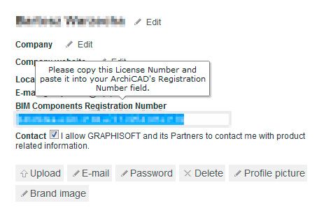

Dear All,
During BIM Components Registration process a number is generated. I am asked to copy it into "ArchiCAD's Registration Number field". Where to find this ArchiCAD's Registration Number field? In ArchiCAD itself, on bimcomponents.com or myarchicad.com?
cheers
grubar
3 Replies 3
When you first try to upload an Object from an Object Settings Dialog or Doors/Window Setting sDailog etc. using the appropriate button in the lower left of the Dialog, that is when you will have to provide this number.
You need to provide it only once.
This way all GDL Objects you upload will be linked to you.
