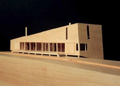

Two images come to mind Laszlo,
First are buildings designed by Canadian architect Brian Mackay-Lyons: high tech barn structures like the Messenger House II (photo) or the Howard House (http://www.mlsarchitects.ca/portfolio/featuredprojects/howard/)
Second is the ArchiCAD 12 Demo project of the antique German beerkeller (sp?) made entirely with curtain wall objects. Bizarre, but an amazing example of what a "curtain wall" could be.
The problem I'm trying to tackle is more like the Howard House where a barn door passes outside the skin of the building. The hardware is mounted outside.
