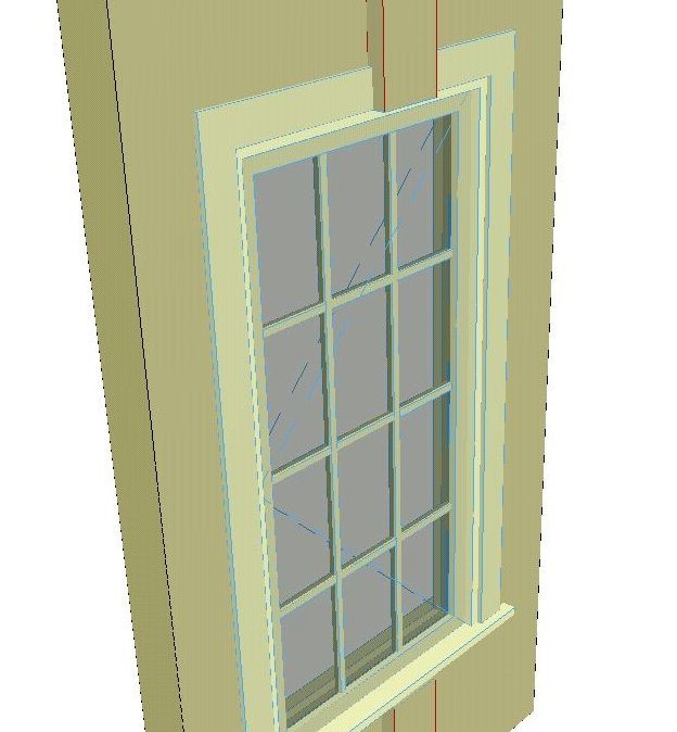

Laura Yanoviak
Polygonal walls are modeled like any other polygonal element (e.g. slab). I would model the siding as a separate component and add it to an un-faced Composite wall (of course, this will require adding an empty opening at every window).

Laura Yanoviak
You'll want your battens to be not-quite-as-deep as your window trim for them to terminate at the trim.
