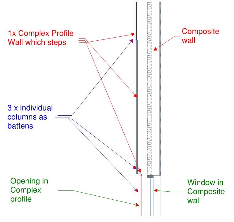

I have board & bat wall siding.
But
1) The walls have different heights,
2) the stud wall behind varies between 6", 8" & 10" in thickness
3) the wall siding steps outboard as does the battens.
4) the battens extend past the bottom of the boards about 3"
What I have currently is:
a) "Composite" for the stud wall.
On this:
b) "Complex profiles" for the siding boards, all modeled individually for the different heights.
On this:
c) "columns" which are the battens.
But for every window and door:
i) I place window in the Composite,
ii) Then place a Opening in the "Complex Profile"
iii) Then manually adjust the height of the "Columns"
Then if a wall of window moves, I have to change all 3 again taking me 3 times as long as just working with a single wall.
There must be a more efficient way of doing this......
Here is a 3D of what I'm trying to achieve and a detail section of the walls & columns I'm using to create it.

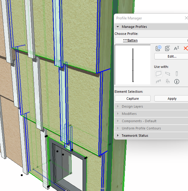

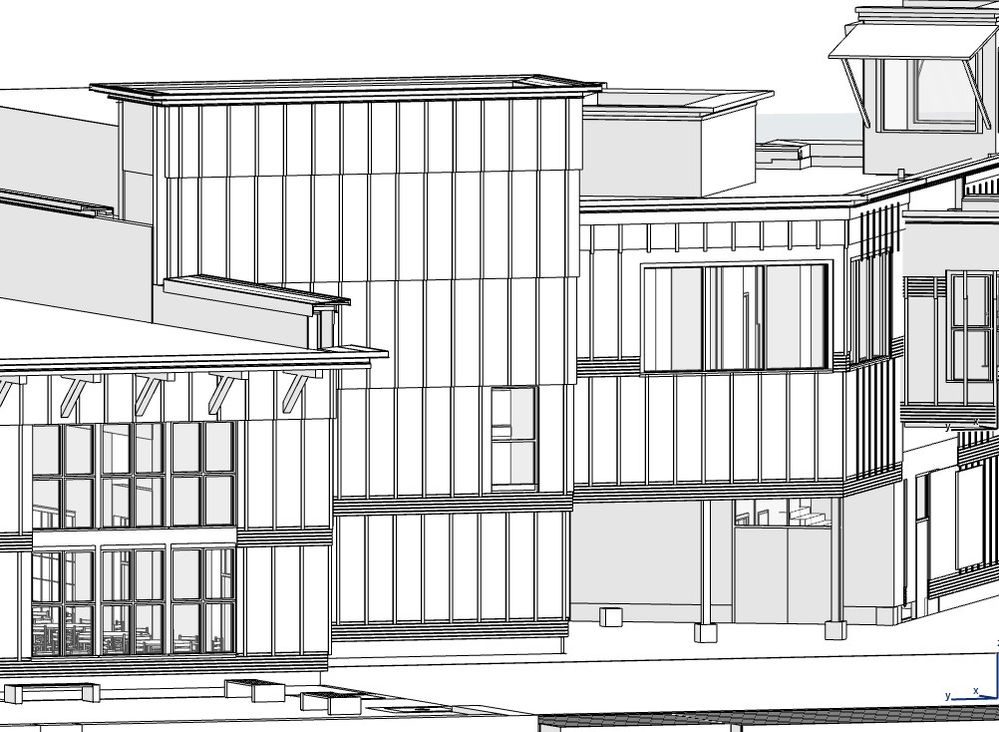

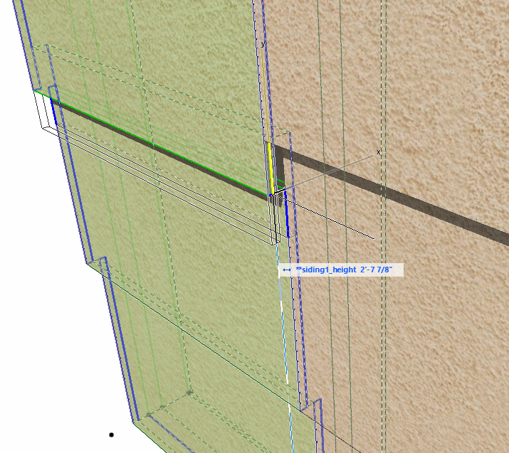

Jere
I'd do the same, but no need to stack. You could use multiple linked offset profile modifiers that would allow you to change both the height and width of each section. The only separate element would be the battens.
For the battens, they could easily be one complex profile with offset modifiers to adjust as needed.
Each "batten" profile contains three separate (one for each wall section), making it easy to stretch around windows. Wall complex profile set so "nominal width" is the width of the structural framing. The two walls shown are the same complex profile with offset modifiers for the depths and heights.
