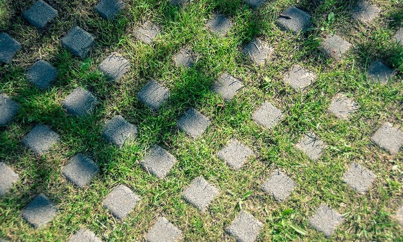

Hi!
Any suggestions on how to make grass stones as in the picture in Archicad?stone grass.jpg
It has to be in 3D and grass is a different material because it will be changed in the grass than in rendering software.
My idea is to make them from slabs and copy past all along 😄 am wondering if there is any other way?
Thank you!

If it is going to be flat then model a slab for the grass.
Small slabs (or short columns) for the bricks - slightly higher than the grass slab.
Distribute using the multiply tool to form the array.
Perform a Solid Element Operation to cut the bricks from the grass.
Render away.
If not level you could do the same with a mesh for the grass - adjust the top surface levels as you want.
Set up a grid of lines in plan for the centres of the bricks.
Then gravitate columns to the mesh using the grid as a guide.
This will automatically set the correct levels for the bricks.

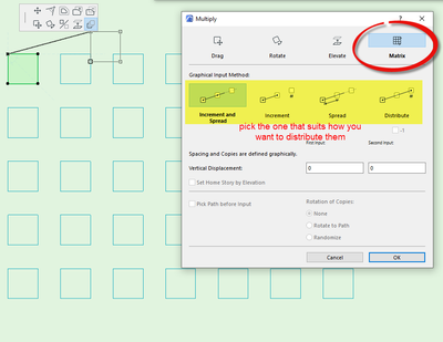

Or just use the multiply/matrix option in the pet palette.
