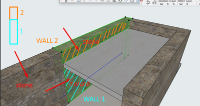

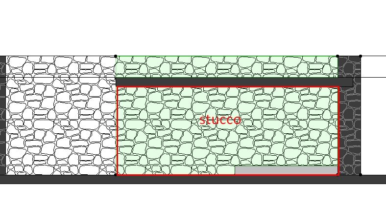

hello!
as you can see in the printscreens i have a stone wall in the outer space and a second (stucco) in the inner space but there the material change to stucco. i use a GO in order to have the stone fill, but i dont know hot to make visible the stucco material.Also the stucco material i want it until the level of the slab. The wall with stucco is a composite (outer skin stone inner skin stucco)
3 Replies 3
Sefa Yakut
You should model your wall as two separate parts. One wall should be covered with stucco material, and the second wall should be covered with stone material.
Lingwisyer
Guru
Graphic Overrides will override an element in their entirety.
If the edge of your slab is stucco, and it penetrates the inner finish, you could possibly SEO downward on the wall inheriting surfaces from the operator.
Ling.
ps. An opening with a Surface Override could also work.
Another way of modeling it with two walls is:
Place a rectangular Opening into the Wall. The size of the Opening will be as large as the stucco plus the Slab.
Then, just place another Wall with Stucco to fill the whole Opening.
