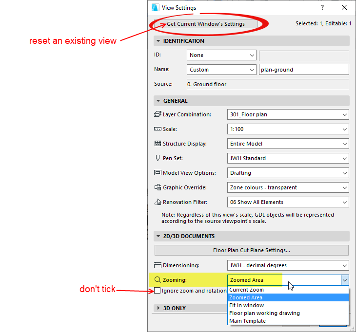

issue 2
This has nothing to do with MVO, it is your view settings.
When you create a view it will store the zoom.
Make sure it is set to 'Current Zoom' or 'Zommed Area'
Do not tick the box to ignore zoom & rotation when opening this view.
If you have an existing view and you want to change the zoom, then zoom as you want, open the view settings and press the 'Get Current Window Settings'

issue 2.
Yes I had version 22 open at the time.
But the settings I was showing are the view settings, not the drawing settings.
Changing the view settings will not necessarily affect what you have already placed on a layout.
Only new drawings you place will have those settings (zooms).
Fit frame to drawing has nothing to do with the zoom you save in the view settings.
It just adjusts the frame of the drawing to fit around what is in the view you have saved.
You can then manually adjust this frame to show/hide what you want.
Click 'fit to frame' again and it will just undo all of the frame crops you have made.
