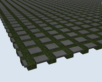

Any suggestions on how to make grass stones as in the picture in Archicad?stone grass.jpg
It has to be in 3D and grass is a different material because it will be changed in the grass than in rendering software.
My idea is to make them from slabs and copy past all along 😄 am wondering if there is any other way?

200 x 200 panels in concrete
80 wide Built-in Butt-glazed Frames with no panel overlap in grass

Hi! interesting solution, that would also work thank you!
In the best-case scenario, I would have some kind of texture (3d texture), which I could apply on paths. There are many paths with this kind of pavement, and modeling/adjusting for each takes some time ...
But workaround with curtain wall or saved objects with multiplied stones works also.
