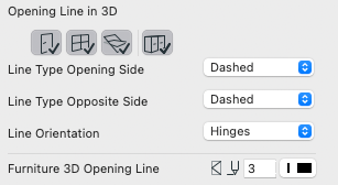

I'm using AC26 on Mac and using default library object, Wall Cabinet Block 26. I have my model view options to display opening lines pointing towards the hinge:

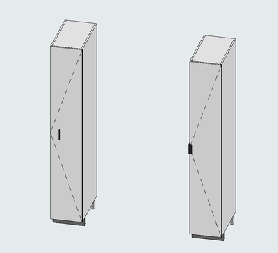

Normal side hinged doors show properly, but my top hinged uppers are showing incorrectly. The upper on the left should have the dashed hinge line pointing upwards. The one on the right I've switched to be bottom hinge just for demonstration, for some reason they both point down:
Any thoughts on workaround? I really don't want to have to manually draw all my hinge lines...

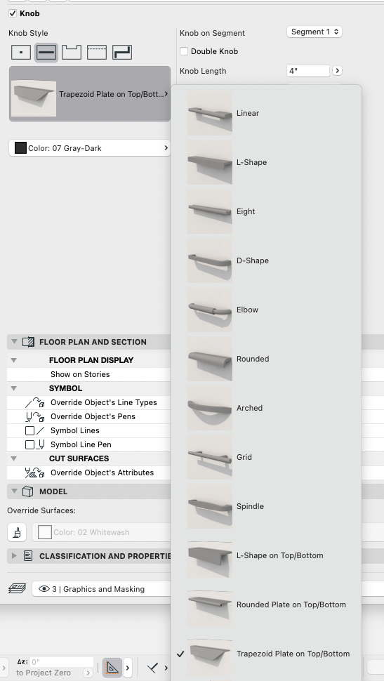

As a side note, and a potential workaround if I could figure out how to do it, is it possible to flip the edge that the knob is on? The linear pull option calls this particular pull 'top/bottom' but I cant figure out how to actually flip it.

This doesn't help you at all, but it looks like they have scripted the casement style doors to use the correct hinge side as you set it, but the awning style doors have not been scripted to allow for that option.
I don't use these cabinet objects, but do you have a 'hopper' door option?
Maybe that in combination with moving the handle if you can would work?

The specific door handle is causing it to flip. If you were to use a different handle, even just "L Shape" (Left in picture) instead of trapezoid, it should be fixed.
Alternatively, use "door mirrored" if it is a single door and not double cabinet
