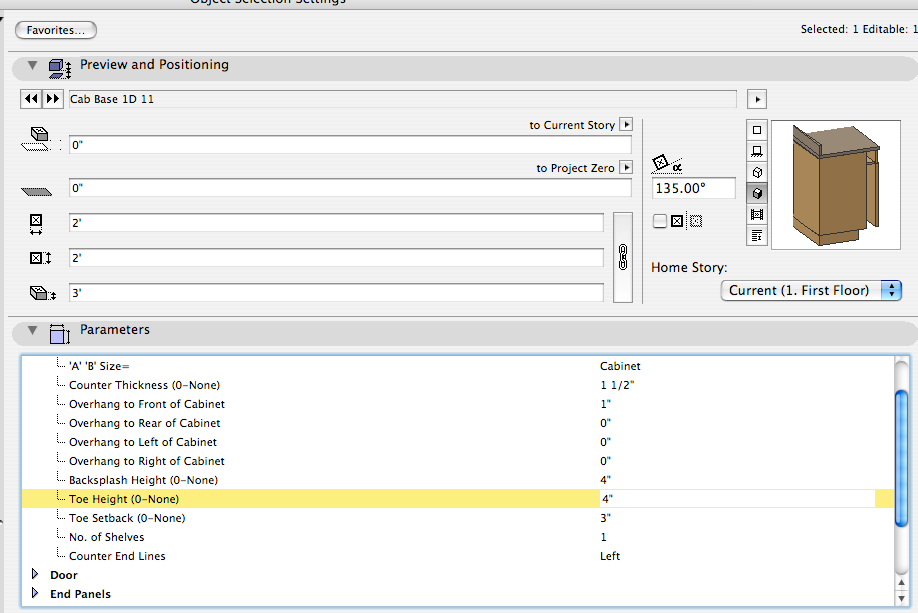

Just checking out library parts, (first time using V12). Tried to make a base cabinet. As you can see by the pictures, for whatever reason the side panels won't extend to the doors.
They want to line up with the toe kick, which also won't display right. Set the toe setback to 3" and it shows 6". Did a complete restart of the program and the computer. Any thoughts out there? I am also going to send a 2nd post which shows a 3D model view.

Are you using V11 object? Your first image seems to say so...
Try using the updated library object.

There should be a AC11 subset library for AC12. If you use the AC11 Subset library instead of the original AC11 Library, it may solve this.

Already reported in another thread as a bug.

Laszlo; Thanks for the reply. I did that and works fine. BUT, we are updating our template and would like no workarounds with libraries. Want the template to be based on the latest build, no patches, etc. Hope GS addresses this fast. It is a very fundamental, very important, building block for the entire program. We still have the smart parts cabinets, so not all is lost. Again, thanks for the input.
It seems like I should have read all posts before replying.
Well, the subset method is obviously a fix, but the AC11 library should also be fixed.

GS confirmed this as a bug to be fixed. (It is the delivered 11 subset library: 'Migration Library' that has the bug. The original 11 library is fine...so the workaround is to make your own subset via PLA for now.)
