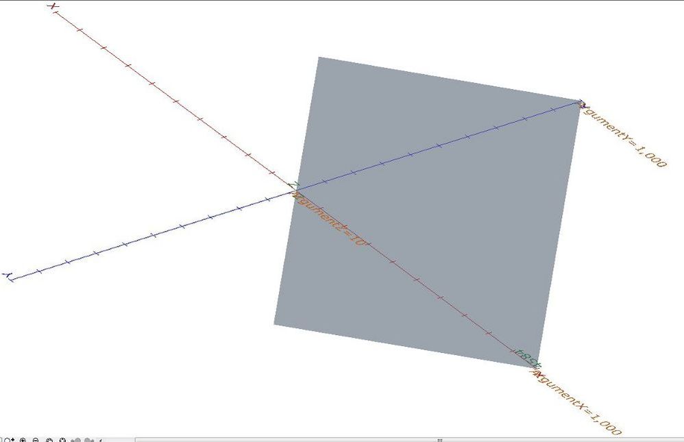

What I really want to do, that is the background for my struggles, is to have a possibilyty to use a cutplane that cuts through the XZ-plane with 90 degrees, and through the YZ-plane at an arbitrary angle.
Hi Anne,
it hase to work as in the image. (I hope it)
Best Regards,
I think you (and I) are absolutely right. Now I went back to the original object I wanted to cut, and thought more easily an practical about it, and suddenly I understood.
Sometimes "I'm lost in space".
I don't see how that cutplane cuts through the X-Z plane at 90-degrees, and through the Y-Z plane at an arbitrary angle. Am I missing something?
The example shown doesn't do this.
CUTPLANE angle will give you a cutplan perpendicular to the X-Z plane and at an angle specified around the y-axis.
CUTPLANE x,y,z creates a cutplane that passes through points x distance along the x-axis, y distance along the y-axis and z units along the z-axis.
It can never be perpendicular to any of the axii because you would need to specify an infinite distance to one of the values which is not possible.
However specifying a distance of 0 (zero) to one of the values will ensure the cutplane is perpendicular to that axis (and passing through absolute zero 0,0,0).
At least that is my understanding of the CUTPLANE command.

Right. I thought that the image in a previous post was somehow supposed to _show_ a solution to the question that was originally posed, rather than illustrate how CUTEND x,y,z works.
