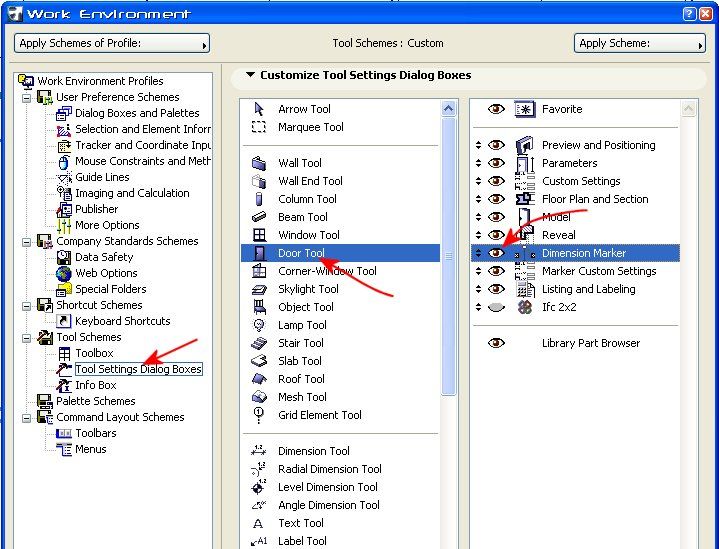

In your Work Environment under "Tool Settings Dialogue Boxes" with Door Tool selected, make sure Dimension Marker eyeball is ON.
