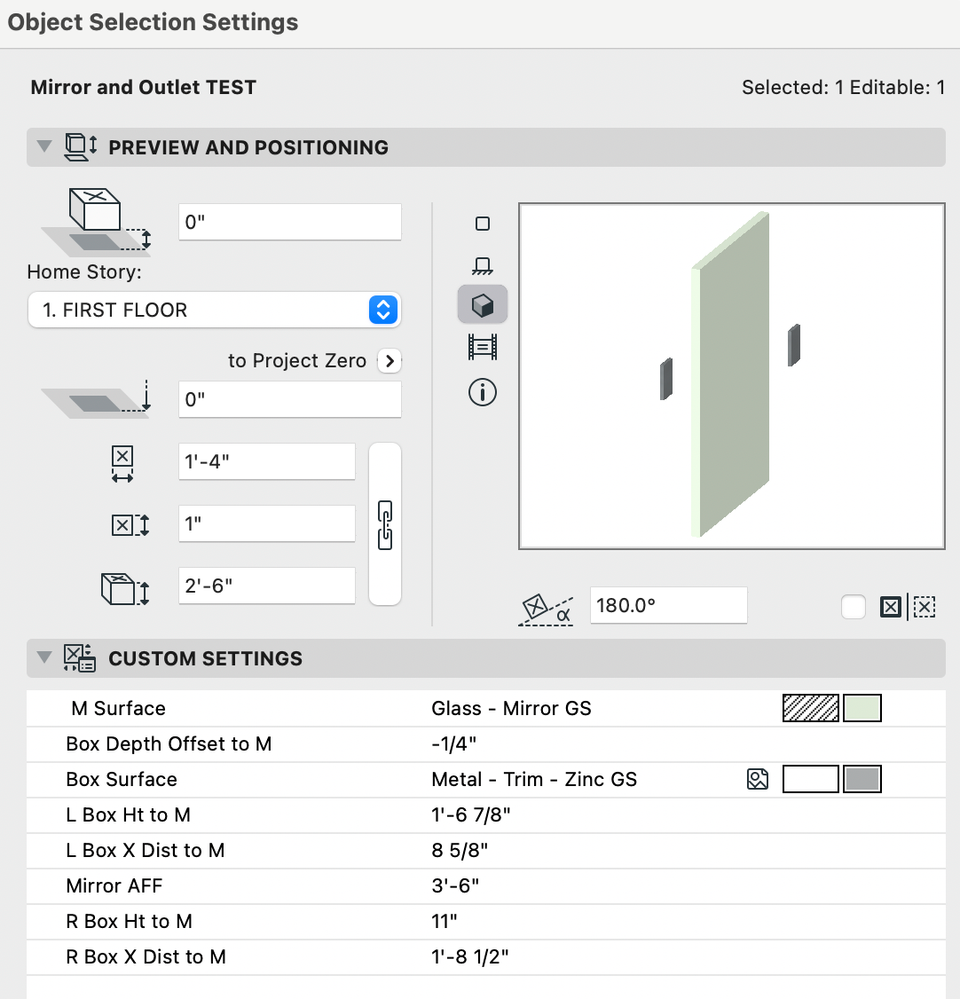

A quick thought: As a limited alternative, you may instead add simple, reference shape nodes (e.g., electrical outlet plates) with the dimensional relationships you need to your primary object (e.g., mirror shape). These reference objects could be either 'buried' in the wall surface (relative to the main element), or clicked off after you put in your electrical boxes.  (For the visibility toggle, you add a Boolean node to the shape node Visibility setting.).  I ran a quick test which is dimensionally correct, but you cannot snap to the elements.  I believe snap nodes can be added in the GDL editor; not sure if they can be in the initial PARAMO creation.
