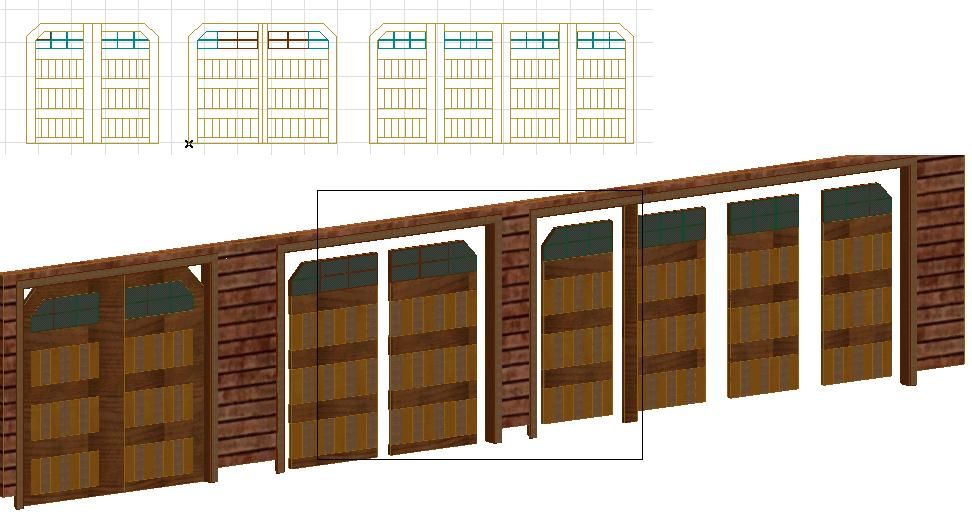

I am attempting to model a door similar to the door # 206 on this web site. http://www.carriagedoor.com/design.htm
I am not having any luck with the AC9 Library.....
Any Ideas?
43 REPLIES 43
Here is the image of what it looks like in 3d

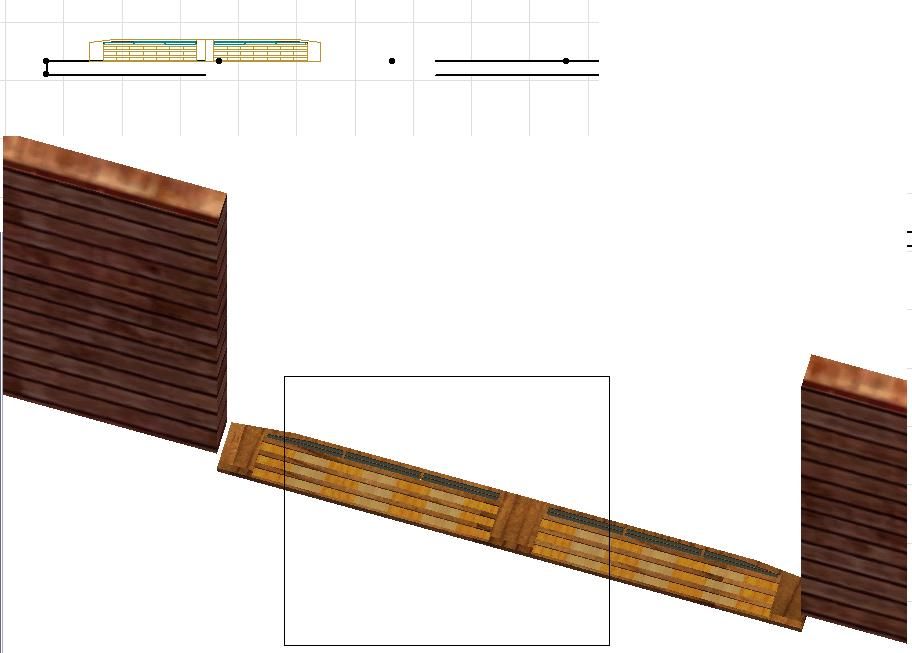

Here is the panel alone inserted in the wall. However this losses some of the options I get when using the method described in this post.

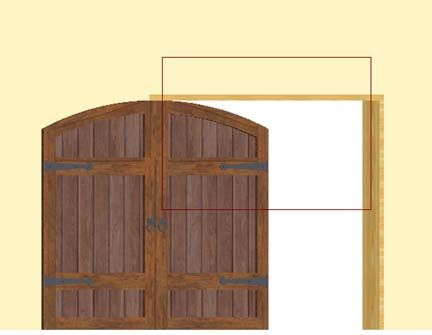

I just got around to trying this method, but when I chose the custom panel, the center of my panel is placed at the edge of the door......
See
This Thread
You must actually be creating doors and not objects. I guess that we can not have arched or angled top objects as custom panels with AC doors and expect them to have a Custom wall hole too...
