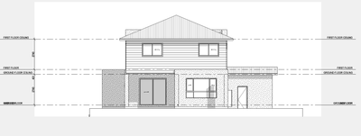

I'm having an issue with my elevations, I'm sure I'm just missing something somewhere, but I'm doing a split level house with the garage dropped down, to make it easier if the split changes, I've set it up as it's own story. It looks great in 3D, and the levels are working how I want. But when I jump into elevations, that story is not showing in the marker. Ideally I'd be showing the garage level below, and sort out the subfloor and ground floor being on top of each other.

Check that box on the right side. It toggles which levels show in your elevations and sections.

Thank you! I knew it was going to be really simple
