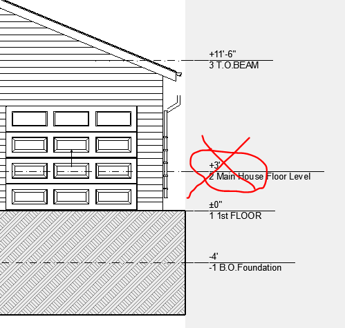

I have a house and a detached garage and in the same  elevation view, I want to show the garage elevation level on the right side and on the left side I want to show the house elevation level only, is there a way do do this?
see example below of the garage. I dont want to have the house elevation level info displayed.

open your Story Settings (default shortcut is ctrl + 7) & un-check the box next to the 2 Main House storey level.
this, however removes it for ALL elevations / sections which have Show Storey Levels turned on.

I wish there is a way to show the elevation level of the house on 1 side and the elevation level of the garage on the other side instead of unchecking 1 thing and doing the other manually.

we've simply used 2D lines & elevation dimensions & not rely on the inherent storey levels present in the Marker Settings.
it gives us more freedom to align them if a bunch of them are too close to each other & dimension whichever part of the building we need to & at which end of the elevation. the trade-off being, should there be a change in storey heights, we have to go change them for each elevation/section.
we've found the auto-storey levelling not as reliable as we'd like it to be. perhaps it got better in the later versions, but we're currently in 22.

I wrote a gdl part so I don't have to draw lines but can still utilize distances from stories.
