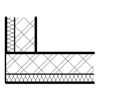

Hello I have run to a problem and I cannot solve it - how can I make these sandwich walls to intersect correctly? I have tried to change priorities but it did not work. I would also like to find a way how to make thick lines work properly.

Hi

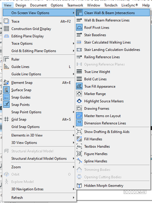

Make sure your Clean Wall & Beam intersections are on.
Thickness of lines are set in composite profiles settings.
Archicad 26, build 3001
Montenegro
Miha_M
Both elements should be stretched into the outside corner. All used materials to join should be equal. Both layers, if on separate layers, have to have the same intersection priority level (number). In On-screen view options you need to have Clean wall and beam intersections enabled.

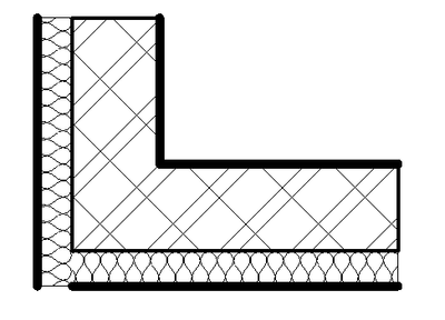

Thank so much, it worked.
And I have one more question - why the thick line finishes earlier? I have tried different settings for the end of the wall in wall settings.
Solution
This needs to be checked on material in composite settings.
