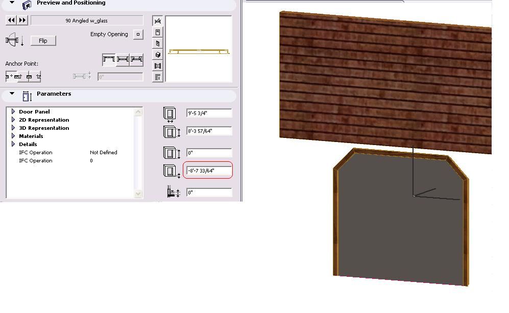

Now my custom door is placing it self -8'-7 33/64" from the bottom of the wall, and I can not change the value, well sometimes I can after messing around with the Parameter Heights long enough.
Well, If you have followed the SAGA. I was saving the door as a binary object (Editable is default, don't know how it got changed behind my back.)
Anyway, even with this option the Wall hole should be recognized. Says Help Manual, ala Karl. Karl told me to save door as a Editable Script and that he will report this as a bug to GS.
