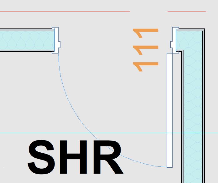

Picking up this thread (hi Laura) - as it's become a wee pet project of mine in this office - where I will need to get a bomber schedule and details set up for a number of medical clinics I'm working on. Laura - if/when you're at your desk, could you screen cap a 1:10 plan view of your most convincing HMC/HMF door frame? AFAIK there is no real way to goose the parameters to make the frame look anything close to an HMF frame....

Hi Andy! I've been away from the forum so long, I needed to update my signature block.
Like this? Sorry, we don't work in Metric, but I don't think scale matters, as I leave my doors' 2D Detail Level set to `Detailed` (screenshot below is 1/8" = 1'-0"). This is the Commercial Door.

Wow - thanks! How'd you manage that parameter magic? Could you please send or post the a .mod file of that? Best I could do is here... was that image of the so called 'metal door'? (sizes not correct yet) - have not been asked to represent these fully yet the way yours show...

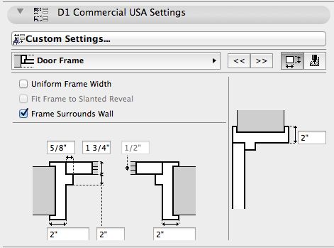

Laura Yanoviak
We use the Commercial Door. Attached are the frame settings. I can't attach a MOD file, but PM me with your e-mail address, and I'll forward.
