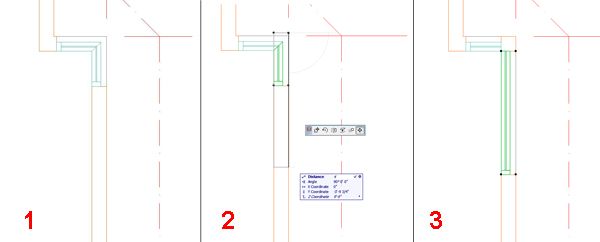

I'm also having the same issue w/ corner windows. Somehow my AC15 Library only has one empty corner window. So I used the corner window library part from AC9. Here's what I did (please see corresponding jpg):
1. Placed the corner window
2. Stretched one of them longer
3. The result is the 2 windows are separated, leaving the corner wall exposed
Does Gerald or anyone have any idea? Thanks!
With the ArchiCAD 15 Object Library 15 loaded, you can use the Corner Window tool and navigate to the 08 Openings 15 folder to use those windows. I tried this and was able to place a corner window and stretch one of its legs.
