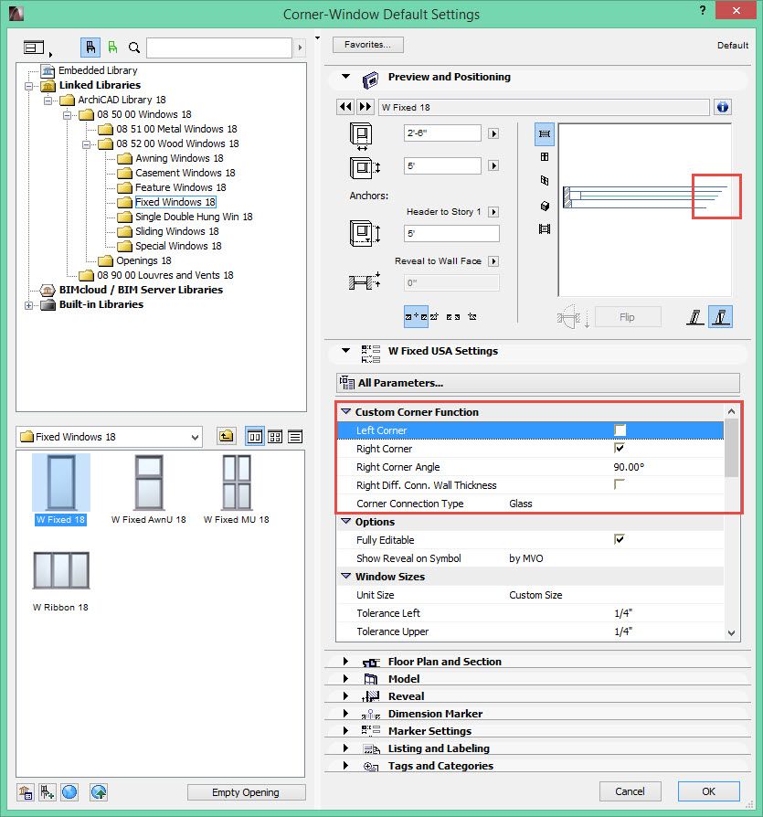

Hello everyone! I have a problem with a window. For some reason, when I try to form a window that turns a corner, it instead forms two windows that intersect each other on the corner. Could it be the wall setting? Happy New Year to everyone!

In the floor plan it looks like that your window frame isn't intersecting right.
What kind of material are you using for your window frame?

Thanks for your answer. I use metal/aluminum but if you open the full picture you will see how the window acts in different way, I cant figure it why.

Try playing with the Custom Corner Functions under All Parameters.

Thank you for your help. I figure it out just flip the windows
