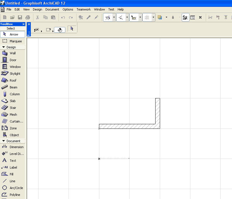

Create a wall

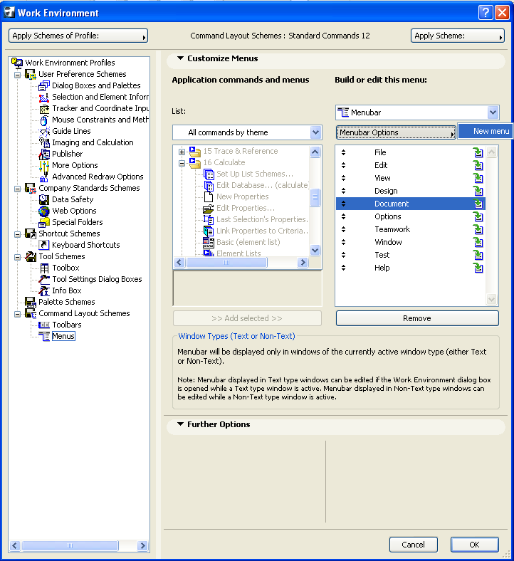

Creating a new Menu for Calculate commands
Go to Options/Work Environment/Menus
Create a new menu in the menubar, and rename it to e.g. Calculate

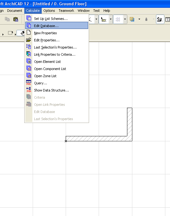

Loading commands to the new menu
On the left under „Application commands and menus” set the list to „All commands by theme, And open folder 16 (Calculate) and select the Following commands: Set Up List Schemes, Edit Database, New Properties, Edit Properties, Last Selections Properties, Link Properties to Criteria, (Open Element, Component and Zone List), Query, Show Data Structure, Criteria, Open Link Properties, Edit Database, Last Selections Properties. And press „Add selected button”. So your newly created Calculate menu will be populated.
Editing database
Go to the brand new Calculate menu select Edit Database command. There in „Databases in Active Libraries” tree you can find „common brick 21,5*10,3*5,6 cm”, but we won’t use this one. Here you can create new component by clicking on Component under Create.

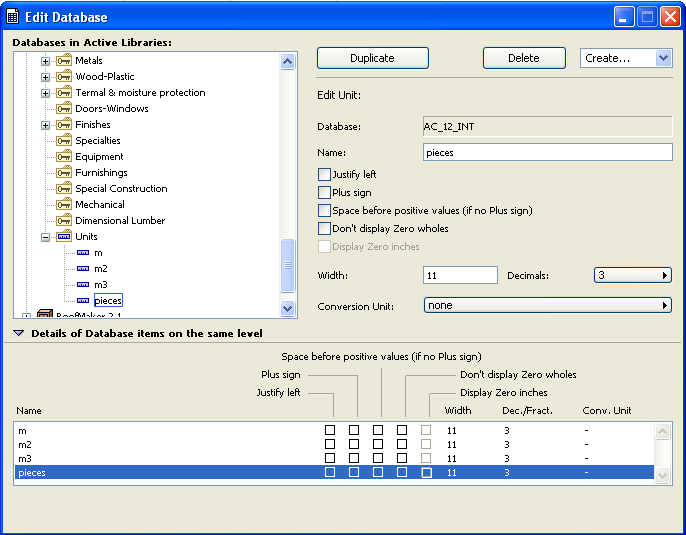

Change the Unit to pieces. Leave Quantity at 1,000.
Set Reference Quantity to Volume.
(If you would like to add a new type of unit like price you have to create it. In that case you have to go down in the main tree to Units, and there where pieces are also present. Add Unit under Create button).

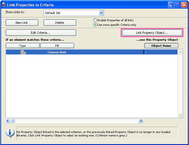

Linking Properies to Criteria
Calculate menu/Link Properties to Criteria button. And in the popup window press New Link button.
Press Edit Criteria button, and select Wall in the Criteria Selector for Find Elements.
Then add another item with pressing More choices, and set it to Fill and finally choose a desired fill type, Common Brick in this case. (This way only the walls that have Common Brick as a fill will be listed in the final outcome).

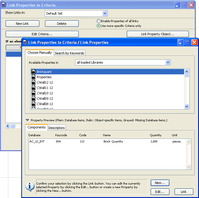

And finally press Link Property Object Button. Select from the Link Properties list the previously created Brickquant.gsm.
If it is done save it. (If the walls that you would like to list have a different fill on the floorplan than Common Brick change them. Otherwise the list won’t be created).
