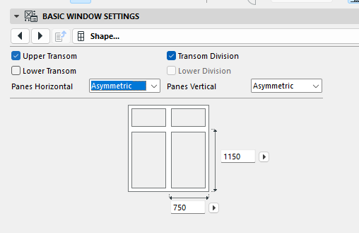

Hi there,
How would I create this window: using the window tool as oppose to the curtain wall tool?
a week ago
- last edited
Monday
by
Just turn on a Transom with the Division option enabled on a Double Window.
Again, it feels like you have not even glanced through the settings available...
Ling.
| Win11 | i9 10850K | 64GB | RX6600 | Win11 | 7800X3D | 32GB | RTX5070TI |
a week ago - last edited a week ago
And then go through the next 3 pages setting the frame sizes and sash types.
a week ago
Oh yeah, that is something that I should edit in the mapping table... The default 100 is one huge non-structural mullion and transom...
