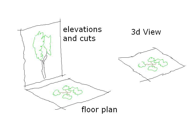

I wanna create an object using only their 2d representation from a dwg drawings.
when i use it in floor plan and 3d views it shows the 2d representation and when seeing from the cut and elevation view it show the elevation block.
no scripts or parametric, just the drawings.
I tried on the images of the gdl master but it is only the representation, not the block actually...
how can i do this??

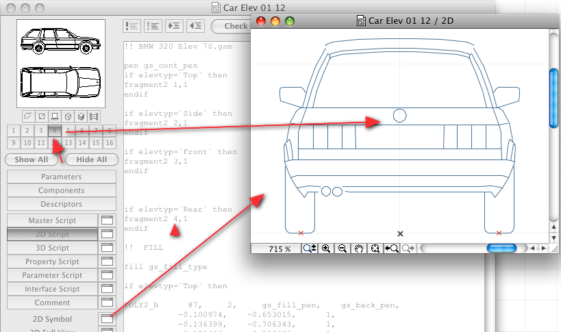

The GDL symbol window supports 16 'fragments', which are much like layers. You can place the (graphic) plan symbol in one fragment and the elevation symbol in another. The 2D script then queries what view it is in (plan or elevation) and displays the appropriate fragment.
You can see part of this (multiple views, each in a different fragment), but examinging the 2D Symbol window of any of the objects in the Vehicle Symbols 12 library folder, and turning on fragments 1, 2 or 3 (little square pushbuttons) in turn. For example, Car Elev 01 12 is shown here. It has a top, side, front and rear view, but is just a 2d symbol, not a model.

You're welcome... but I just noticed that you wanted to see the sketch in a 3D view also. To do that, you'll need a jpeg (etc) of it and use the parapicture object that Dwight talks about in various threads. He has uploaded it to the GDL Depository.

Hello,
You can open the 2D-DWG as an object;
Archive...-> Libraries & objects...-> Open object...
This creates an GDL-object where the DWG 2D-lines visible in the 3D-view too. The lines are
lying on the XY-plane, but with the "rotx 90"-command the drawing wireframe is rotated
vertical to the XZ-plane.

YESSSSSS Juha...
That exactly what I want...
The only thing is that in the elevation I need another dwg drawing... not the same.... is there a way to combine them??

Hello,
As Karl suggested using the GLOB_CONTEXT variable it can be done automatically.
if GLOB_CONTEXT=4 then ! show elev view in section or elevation
   !---> paste the 3D-view code here
else ! show plan symbol for all other views
    !---> paste the other view code here
endif
