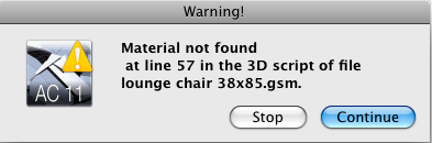

Is anyone able to advise if you can use the CUSTOM PROFILE tool to create library objects with that do NOT have script errors when you check them.
I have spent HOURS trying to get this to work and even the examples provided in the ArchiCAD11 guides produce script errors when checking.

First, when you do a Checkscript, rather than click 'Continue', if you click 'Stop' the code in question will be highlighted...

The error is missing materials, which are indeed missing on my machine since these are things you must have defined:
00 | Default Fabric 1 sofa
and
DEFAULT
If you have materials with these exact names, then it is possible that the problem is the vertical bar symbol, as I've seen that cause problems on Windows machines (but not on Macs). But, if you know scripting, if you replace all three materials text strings with a reference to a material parameter, the message should go away ... and lead you to the next thing to fix...
I simply duplicated one of my materials twice, and gave it your names (the two names above) - and then CheckScript was totally happy. So, no real problems that I see...

I come after the battle, Karl already did the job.
For autoscripted objects, you have to make material definitions parametric. This is not automatical.
Create two parameters, mat1 & mat2 (lounge chair 38x43.gsm object)
In 3D script use the search and replace function.
"09 | Paint-08 Black" -> mat1 ! no quotes
"00 | Default Fabric 1 sofa" -> mat1
"DEFAULT" -> mat1
"09 | Paint-06 Grey" -> mat2
Still tiny corrections to do, because some tools refer to a materiel definition by index (not parametric)
In sprism_{2} statements, search and replace (at the end of lines)
ind(material, mat1) -> mat1
In revolve{2} statements, search and replace (at the end of lines)
130 -> mat1
Done, no more alerts, materials are parametric.
