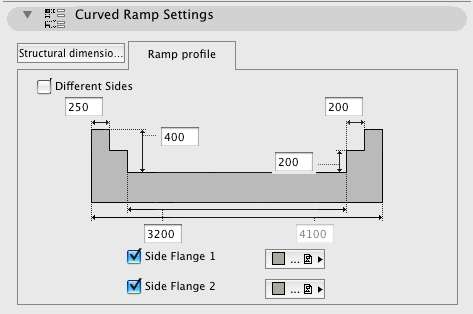

Greetings folks,
I've noticed that mentioned library part has bug under 2D representation options.
There are 3 types of 2D representation:
- COMPLETE,
- HORIZONTAL CUT,
- DASHED OVER HORIZONTAL CUT
Whatever you choose, AC will always display last one (dashed over horizontal cut), with cut line on app. 100cm above ground.
Is there anyone who could help me with this? I would REALLY like to remove this line in some drawings.
Thanks!

well i was also using it and I think another problem shows if the angle of the curve is less than 45 degrees, the 2D representation shows a full circle no matter what. I think it is a bug.

whatever:
I just played with this object a little bit, and found the problem you described, then set the Ascent Length to a smaller, appropriate length, and the 2D symbol displayed correctly. Also, the 3D model of the part was irrational with the too long Ascent Length. You may need to make sure that the parameters are set to appropriate values for such a short ramp.

Thanx david, but actually Ascent was turned off, and actually you can tell its a bug looking at the parameters where it mentions the slop angle ( grayed one ) , the value is negative!
I usually model the ramps using the mesh-SEO-mesh trick, but I was trying to show a new user different options, but it looks like doing it the old manual - non intelligent way is still the only way .

whatever:
With your settings, does the ramp look OK in 3D?
Could you post a screen shot of the Parameters > Ramp part of the dialog box (including the Height) so we can see your parameters? This may help us or the person at Graphisoft responsible for this object understand the issues.
