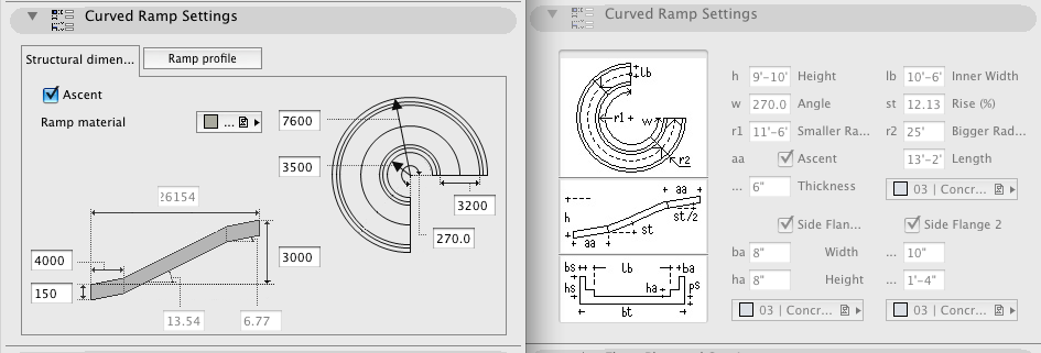

I've noticed that mentioned library part has bug under 2D representation options.
There are 3 types of 2D representation:
- COMPLETE,
- HORIZONTAL CUT,
- DASHED OVER HORIZONTAL CUT
Whatever you choose, AC will always display last one (dashed over horizontal cut), with cut line on app. 100cm above ground.
Is there anyone who could help me with this? I would REALLY like to remove this line in some drawings.

Not only the sloppy bug in the INT script, but on looking at the US script, it has a stupid English-German translation inside rather than doing something smarter as in the INT script.
The INT UI looks nicer in my opinion, see attached screenshot - INT on left and US on right. It does exhibit a pet peeve I've had for many versions - complained during betas with no result: there is lots of space to make the data entry fields larger, but for some reason GS likes to make them so small that in the metric case, a digit is being chopped off here - and in Imperial, we frequently cannot see the foot or inch symbol or, like metric, critical digits. Also, look at the ramp material field in the INT case at left - you cannot read the name of the material at all. No reason at all that this field cannot be quite wide. I see this issue with material UI fields all over the library. It is a quick fix, but GS does not seem to care.)
I really do not understand why this ramp object is not the same for every user, regardless of country...

whatever:
I just played with this object a little bit, and found the problem you described, then set the Ascent Length to a smaller, appropriate length, and the 2D symbol displayed correctly. Also, the 3D model of the part was irrational with the too long Ascent Length. You may need to make sure that the parameters are set to appropriate values for such a short ramp.

David
Thanx david, but actually Ascent was turned off, and actually you can tell its a bug looking at the parameters where it mentions the slop angle ( grayed one ) , the value is negative!

whatever:
With your settings, does the ramp look OK in 3D?
Could you post a screen shot of the Parameters > Ramp part of the dialog box (including the Height) so we can see your parameters? This may help us or the person at Graphisoft responsible for this object understand the issues.
