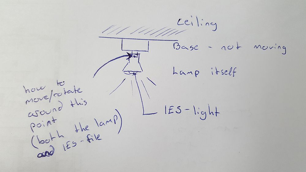

I'd like to create a downlight, with a parameter that allows me to rotate the "lamp" part of the luminaire (with ies-file attached to it). I have problems specifying a point which the lamp rotates around, any suggestions ?

I can't say I have ever played around with scripting lighting objects so I'm not sure how the IES file fits into the equation.
You would need to model the base.
Then move the local origin to the rotation point.
Add the ROT commands.
Script the rest of the light (based on 0,0,0 which is the local origin now) and I assume this is where you would add the IES info if that is what you need to do (I am not sure about this part).
Then DEL the ROT commands for good house keeping.
Just had a quick look and there is an IES Light object that appears to be just the light itself.
So model the fitting as above - i.e. model the base and move the local origin and add ROT commands ready for the moving part of the lamp.
Then when it comes to the lamp part you would model that and then move to where you want the light source to sit in the lamp part (i.e. move the local origin again) and then CALL in the IES Light object (feeding it whatever parameters you want to control).
DEL all the moves and rotations.

Hi! After modelling all the other things in for the fitting, how do you call in the IES Light?
JaseBee
CALL 'IES Light 21' PARAMETERS ParmeterInCalledObject = Value [,AnotherParameter = AnotherValue]
