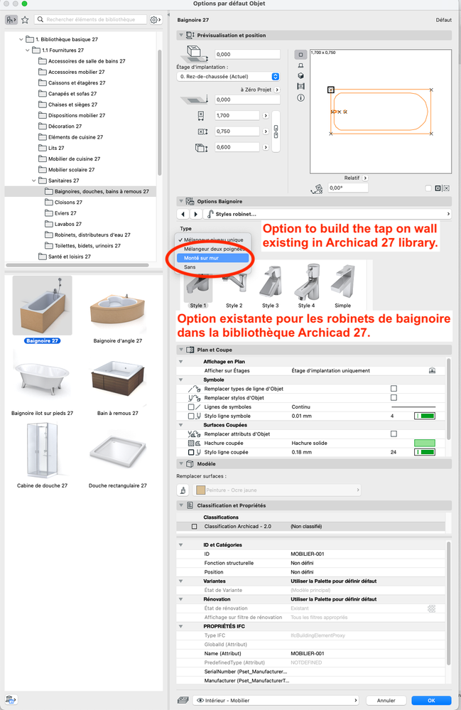

Disappeared option for bath object in the .libpack 28 standard library.

You attached two images of the same 27 library.
Did you mean to attach one for 28?

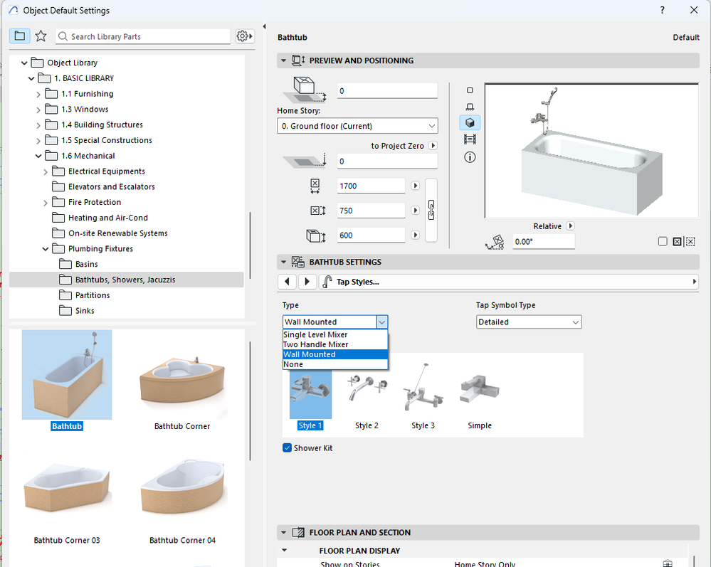

Wall mounted taps are there for me in 28.

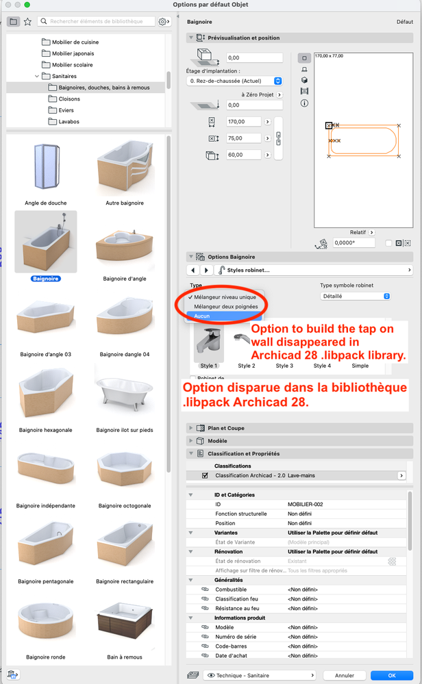

BrunoH
Hi Barry,
Sorry this is the one I wanted to attach for Archicad 28 .libpack version :

You might need to speak to your local French Archicad support about this.
Or maybe @Magdolna Marosvari wouldn't mind shedding some light on this.
I am not sure why a different language localisation would have this setting missing.
Especially if you had that option in 27.
I think there is a mistake there somewhere.

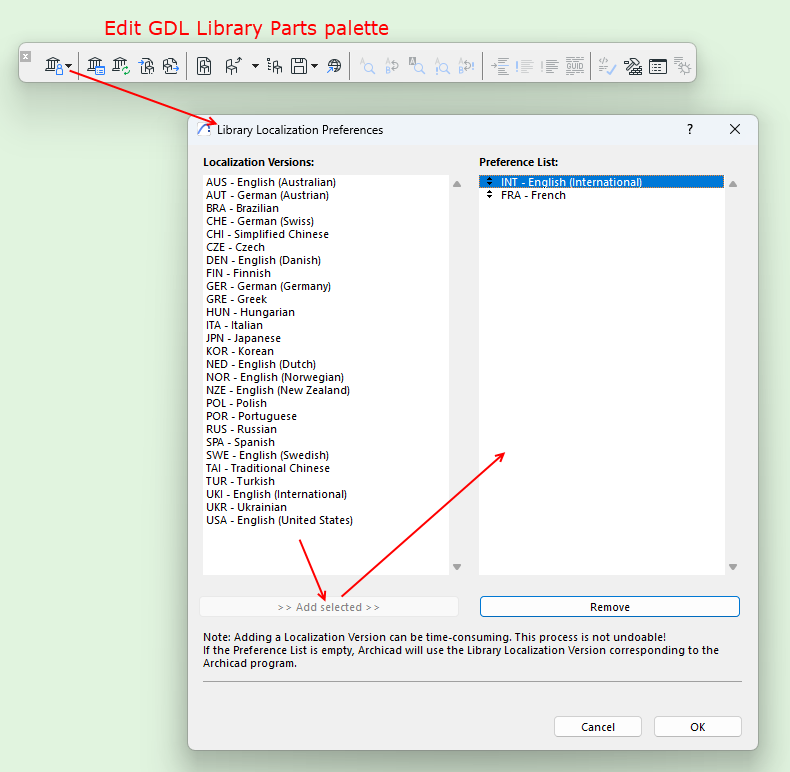

I just changed the Library Localisation Preferences to French and the option for the wall mounted taps disappeared.
Adding the INT preferences (and putting it first in the list) made the option re-appeared - but of course the library was now in English language.
If you don't have the FRA localisation in your list, I believe that is normal as your French template will automatically use that localisation.

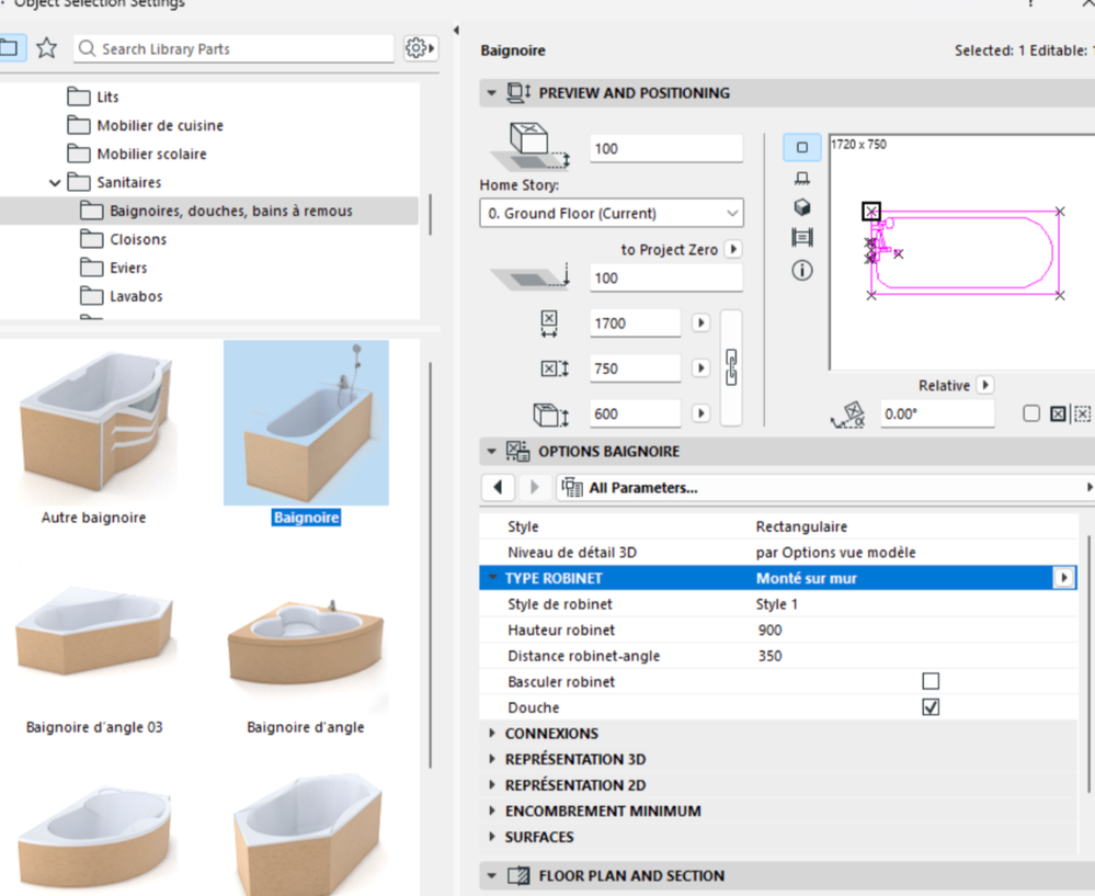

We were able to reproduce it as well in AC29 TP1, and it is indeed a bug. We're currently investigating the root cause and evaluating how best to fix it. In the meantime, as a workaround, you can find the missing setting in the All Parameter list.
