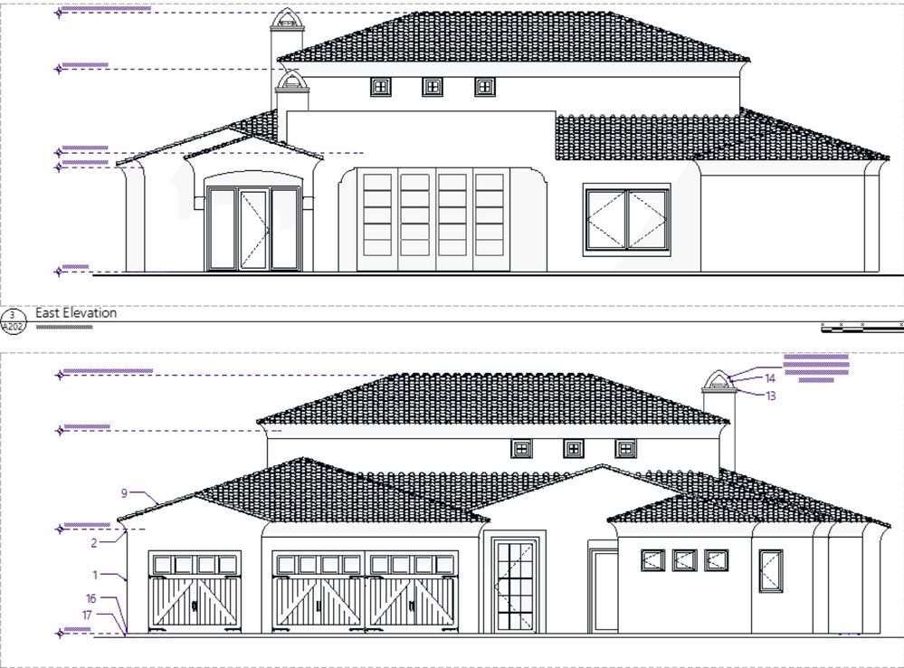

Hello,
I am trying to have my 6 windows (as seen on the elevations) that are on a different story appear on my noted floor plan. When the windows are on the main floor story but above the cutting plane height I can changed them to " projected with overhead" or "overhead all" and they will appear but I can't figure out how to have the appear on the main floor plan when they are on a different story. Any help would be great.
Thanks
4 REPLIES 4
I need them to show up here on the floor plan
You need to adjust how many stories up your view is looking to in cut plane settings for the vies
I have tried that but to no avail, are there any other suggestions or maybe a walk through of how to change the view settings to show these windows 2 stories above the cut plane?
Thanks
A screen shot of your story settings, cut plane settings and window settings will help resolve it
