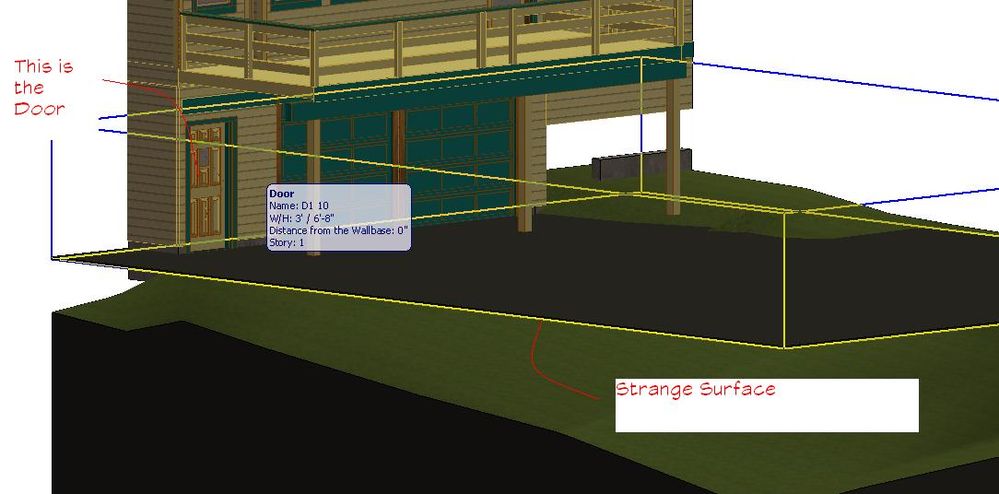

I have a Marquee in the plan view. If the Marquee is viewed in the 3D window the D1 10 Door creates a strange plane (Maybe the Threshold). Opening the Door settings and having the preview option to plan view (top button) I also get this error/Warning:

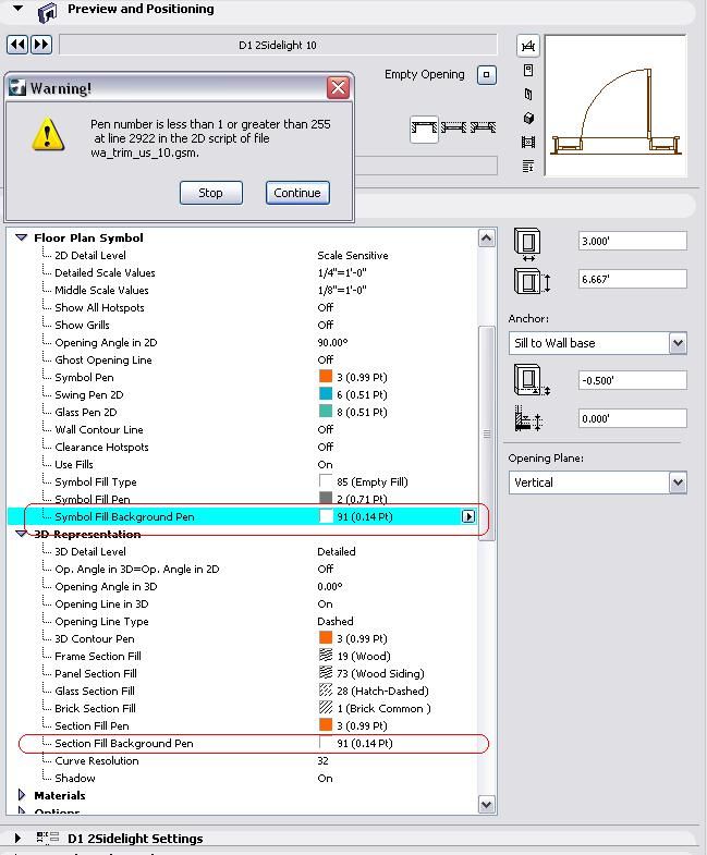

"Pen number is less than 1 or greater than 255 at line 1072 in the 2D script of the file wa_trim_us_10.gsm."
If continue is selected the same warning at Lines 2895 & 2922 appears.
For the windows in the project I get a similar error/Warning except it is at Lines 1358, 1452 & 1487.
Possible two separate matters. Any help would be appreciated.

Well, for the doors, I did find one 2D fill pattern & one 3D fill pattern that where set to -1 (Window Background). Changing them to pen 91 (White for me), did not resolve the problem.
The Windows had only the 2D fill that was set to -1. Changing it also to pen 91 did not fix the windows either.
I mean there might be some 2d line or fill pen (not fill background pen) with the -1 pen...
For example, I managed to replicate the issue by setting the "swing pen 2d" to -1.
Check any pen set to -1 and change it to a different one.
