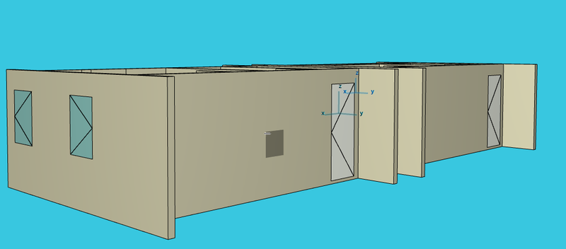

My first try with the new 29 library packs and all my doors and windows show up as simple slabs with no detail.

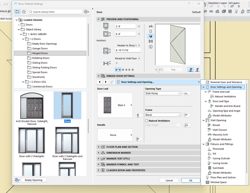

Here's a 6 panel door, and what it shows in the preview window is the same as it shows in the 3D.
Same for windows.

Check your MVO settings. I am assume it is set to Simplified doors and windows.
Ling.

Yes, that was it. Thanks! I haven't opened that dialog box in years! It just always transferred the settings from previous versions.
