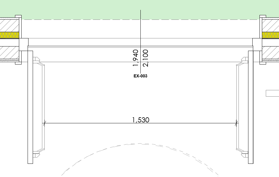

I haven't found a way to turn on handles in floor plan view for doors and windows (I checked the library part settings and model view options) for the default library parts with symbolic view. Is there a way to do this? I don't want to open doors in 3D and draw the opening lines manually, so using the projected option is not a solution now.

Go to hinged door settings > door settins and opening , 3d detail level - FULL > handle and kick board ; select a handle > opening type , 2d and 3d opening angle 50.00 > model attributes, 3d detail level - FULL .
Now go to floor pland and section of hinged door in settings and Floor plan display set Projected !
As pointed out by the OP, the issue with doing this is that it does it not show opening lines and is linked to the 3D opening angle / length which means it will impact your elevations, sections and 3D views.

- Turn on your handle;
- 3D openning angle with 90º;
- In Floor Plan Display (Element Settings) > Projected with Overhead;
Make sure your door options in model view option are correct.

You need to set the Floor Plan Display to Projected, and then open the door leafs in 3D. The leaf's rotating line won't appear, but the door handles will be visible. You can either code your own doors or manually draw the rotating line.
