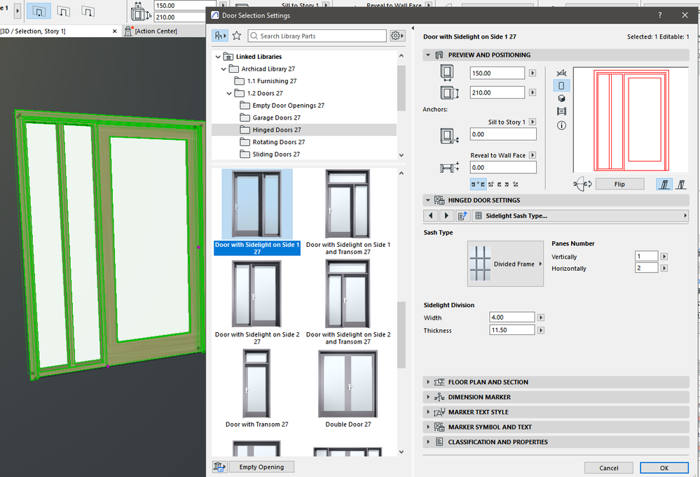

is there i way to create a door with double side window? in library i can only find with just 1 window max that can be divided horizontally and not vertically
2 Replies 2
CosminF
You can split the sidelight into two parts (if that is what you are trying to achieve) but not have two sidelights side-by-side:
hope this helps

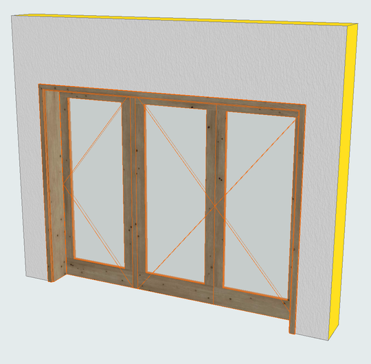

You can put to or more doors and windows together.

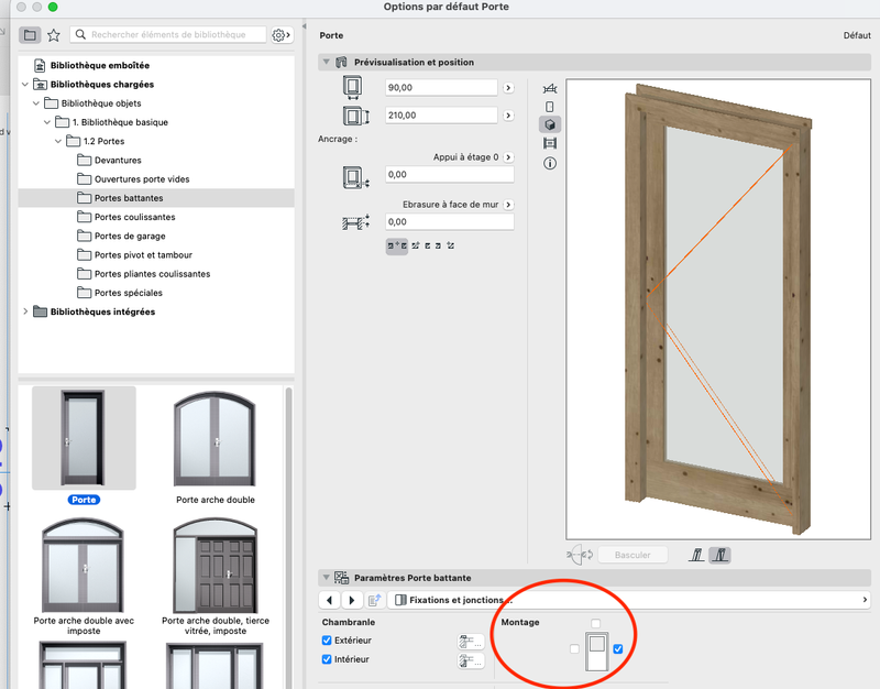

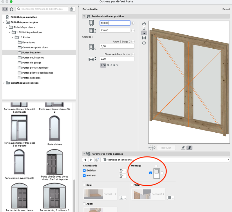

Use the mounting options to connect them.
