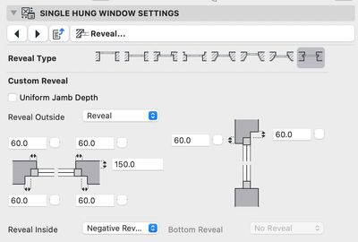

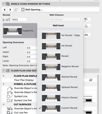

Hello everyone,
I know the issue with not being able to show splayed reveal on both sides of the wall has been discussed before, yet there's still no real solution to that.
When looking at the window reveal settings now, it appears that Archicad have updated the Custom Reveal image to show splays on both sides, however, it's still not an option when you actually go in its settings.
Am I missing something? There's no option to customise the angles, yet the example preview image shows exactly what I'm trying to achieve.
I'm working in Archicad 27 (Mac)

Can you just use an Empty Window Opening with splayed reveals facing inward?
Win11 | i9 10850K | 64GB | RX6600 Win11 | 5900X | 32GB | GTX2080TI
kristinesenko
My Empty Window Opening does not appear to have the option for splayed reveal 🙁
