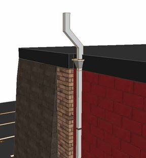

Downspout Complex shows the gutter head below the offset. In the options you can turn off/on gutter head and elbow, but no options for offset to be turned off. Even if I were to require the offset (but not in my current application) it is above the gutter head and I can not seem to find the editing point to adjust the head to be at the top.
I have in the past just built the downspouts with the available parts, but would like to remedy having multiple parts by using the complex.
I have noticed this back in 12 and maybe older version.
I'm Finally fet up enough with this complex to ask for help.
Thanks

I just hoped that Archicad had made a more usable object and there might be a simple way around it. I am not proficient in GDL and like to use what is available if possible.
I'm currently considering a complex profile for downspouts...but what about the headers. I really would like for the whole to be one object, not pieced together.
Are there any other suggestions out there?

Hi Lindsay,
I've hopefully modified the existing Downspout Complex to do what you requested. Let me know if it doesn't work, or if you discover any major bugs. I also noticed that the 2d view was incorrect when the object was tilted over, so this was corrected too. As a bonus I've included some modified hanger macros that pulls the hanger away from the wall slightly for better display!
It was actually quite an interesting exercise to do and it genuinely increased my understanding of graphical hotspots and trigonometry, so it was worth doing for my own education!
Hope it's useful to you!
