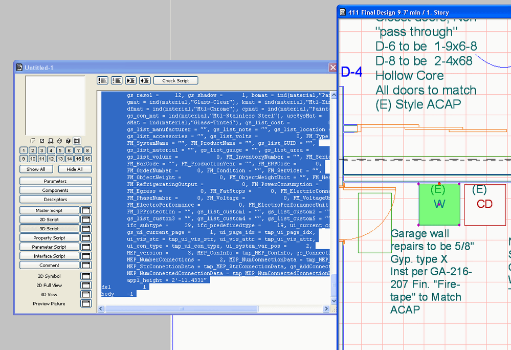

Don't know if this helps much as I'm a complete newbie to gdl but here is a screen shot.
I just used the middle button. The one between the grey X and the _ minimize button (on upper right of screen), to get the floor plan to NOT take up the whole screen area.
Then opened a "New Object" dialog.
Did not "dock" but that's ok it sits just fine on the main screen alongside
the floor plan.
It seems to work, dragged 3d object from floor plan into 3d window part of new object dialog.
