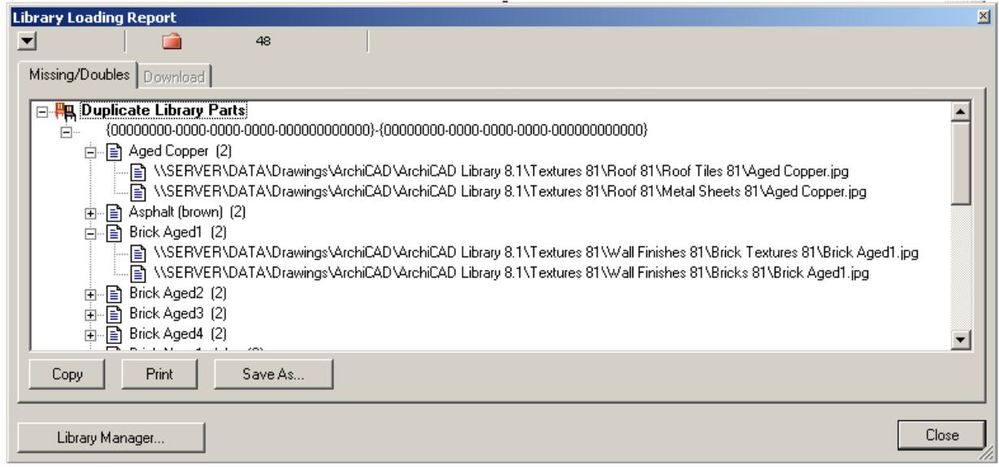

Can anyone help me in relation to duplicate library parts. Every time we load ArchiCAD we get the following attached error message. Is this due to the library being loaded twice or are there known conflicts with the latest update R2.

The files are physically duplicated in the paths shown in the error report. The duplicates do not harm anything, but something is wrong with your library organization if you are getting this. All of the versions of the materials suggest that someone in your firm has created some custom materials and got copy-happy in placing them in the library...
Karl
