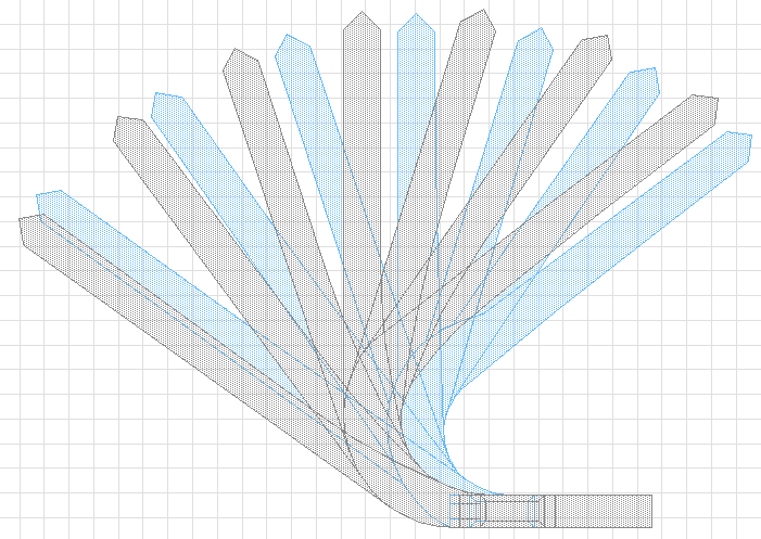

A Dutch AC10 Library has fallen into my hands. There are some very simple objects showing with considerable detail the 2D turning radii for cars, buses, trucks. For each vehicle type there are 2 versions, one tighter than the other one ('Auto 1' shown in blue with 'Auto 2' overlaid in gray).
I would figure the two types must be Dutch-code related in some way, linked to speed or traffic or public/private nature or whatever. Any idea what the two versions mean?

Maybe the blue is assuming the vehicle is on full wheel lock straight away and hence is the tightest possible turn.
Where as the grey is a more gradual steer into the turn starting with straight wheels.
The grey car is further back giving it a chance to start with straight wheels and then begin turning.
So I think this is more likely the reason.
I still like to think the blue is turning in reverse as the front will swing out wider as shown, but the image of the blue care is not reversed.

The two versions mean the old and the new standard.
In the ArchiCAD version 8.1 was a change from the old standard to a new standard but the user asked for having both in the library.

What do you mean by 'the old and the new standard'? What standard, what years?

Judit Boros from Graphisoft did some research with the user who had originally requested the objects, I am pasting what she found out below. I tried to find some details about what those codes are, where they apply, etc., but not a lot of success on that yet.
I contacted our German partner to find out the most details about this issue.
There was a change in the DIN (German Standard) in year 2001.
The Bundesministerium für Verkehr, Bau- und Wohnungswesen - made an order in year 2001 that was introduced with number 287.
This standard overwrote the existing norms from 1995 to 2001.
This order contains the same drawings and Schleppkurven as ArchiCAD.
The reason of this change is not known.
I guess there are more components, for example speed etc.
That is all I could find out.
