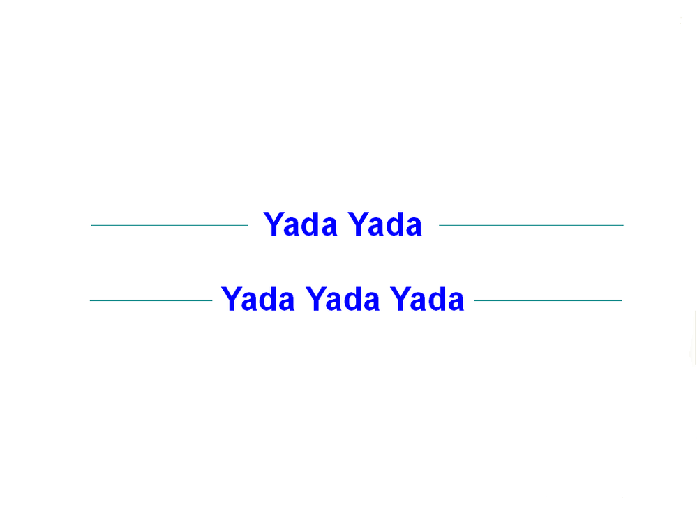

Is there a way to determine the physical length of a string of text. I'd like the lines to start a certain distance away from the beginning, and end of the text. I thought about just using a line at length A, centering the text on the line then placing a fill between the two. The Problem is that the fill would have to be able to change with the length of text as well. (See attached image) Or maybe I'm going about it the wrong way??
Any thoughts would be appreciated.
Doug

Hello, this might help.
!2D-code-----------------------------------------------
txt="Lorem ipsum"
define style "style01" "Arial", (2.5/A_)*A_, 5, 0
set style "style01"
length_txt=STW(txt)/1000*A_
text2 0, 0, txt
line2 -a/2, 0, -length_txt/2, 0
line2 a/2, 0, length_txt/2, 0
hotspot2 0, 0
hotspot2 -a/2, 0
hotspot2 a/2, 0
Regards, Juha
