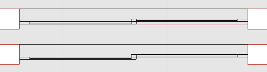

Is there a way in ArchiCAD 11 to have this window - W Emergency Escape that looks like that:
to look like that? [the way it looked in ArchiCAD 8]
This way it's much more clear it's a sliding window.
I just need 2 lines removed.
Could someone guide me through what I have to do
or be kind enough to change it for me, please?
Thank you.

Simple, set the scale sensitivity as attached.

Well thank you Rod but I think doing that is not going to give me the looks that I need.
If you look carefully you'd notice the difference.
I made another picture to make it clear - I need the red lines removed from the 2D symbol.
This way it is clear the window is sliding. With the extra lines it's hard to tell from a regular window.

Vic, the scripting today is extremely complex compared to earlier versions.
Therefore try the following.
Copy and rename the window from 8 that works the way you want,
then load that into your project library.
Just beware that it too, may call macros, which will need to be loaded in your working library.
Copy those to a folder, named Macros XX. This may throw up messages of duplicate parts,
but you will have your window as you wish.

Vic, attached find zipped window with macros saved from V 8.1.
I have opened in 11 and all works. Let us know if things work ok
at your end. Just load in your working library, again you may have
duplicate error messages.
