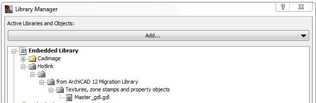

I'm in the process of creating a new clean template & noticed that an Embedded Hotlinked Library from an ArchiCAD 12 Migration Library. The weird thing is i started from a Default AC18 template to fully start fresh. I don't remember copying anything into the template.
I have other libraries added with some personalized objects / .gsm's from older versions of ArchiCAD (10-13)
Firstly, This current company I work for hasn't been around long enough to have used AC12.
Secondly, How do I delete this embedded hotlink when I did actually set one up. Therefore can't be deleted? could it have been associated to another library object/.gsm/Folder?
Can anyone help?

Do a new and rest all (Ctrl+Alt+N) and see if the hotlink remains.
If it does, I think it could be a Cad Image thing.

This just wipes everything. I have already set up some elements of my template & didn't really want to start again.
It also, weirdly got all of the folders & files within the ArchiCAD 18 Library & placed them individually as linked libraries. Not within the Archicad 18 Library folder as normal.
If i was going to start again i would just start with the default domestic 18.
Thanks for your recommendation.
Apologies mate I didn't mean to start working from a a full new & reset all, more just testing to see if the embedded mods came in with the cad image add-ons.
