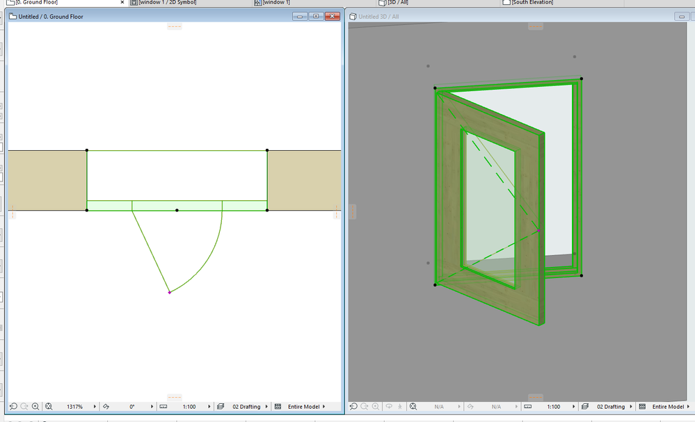

I noticed an inconsistent representation of the 2D symbol of the windows, i.e. the opening mark which seems to be sized on the glass and not on the opening frame. This becomes particularly evident in the case of very wide frames.

yes you are right thats a coding mistake and since the window is from the program library is impossible access to code and modify it and save as, may be the solution us create a new one
