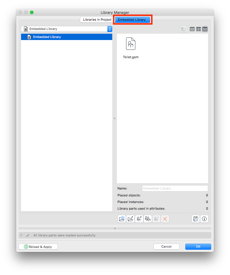

 1. Go to File > Library Manager.
2. Click on the Embedded Library tab.

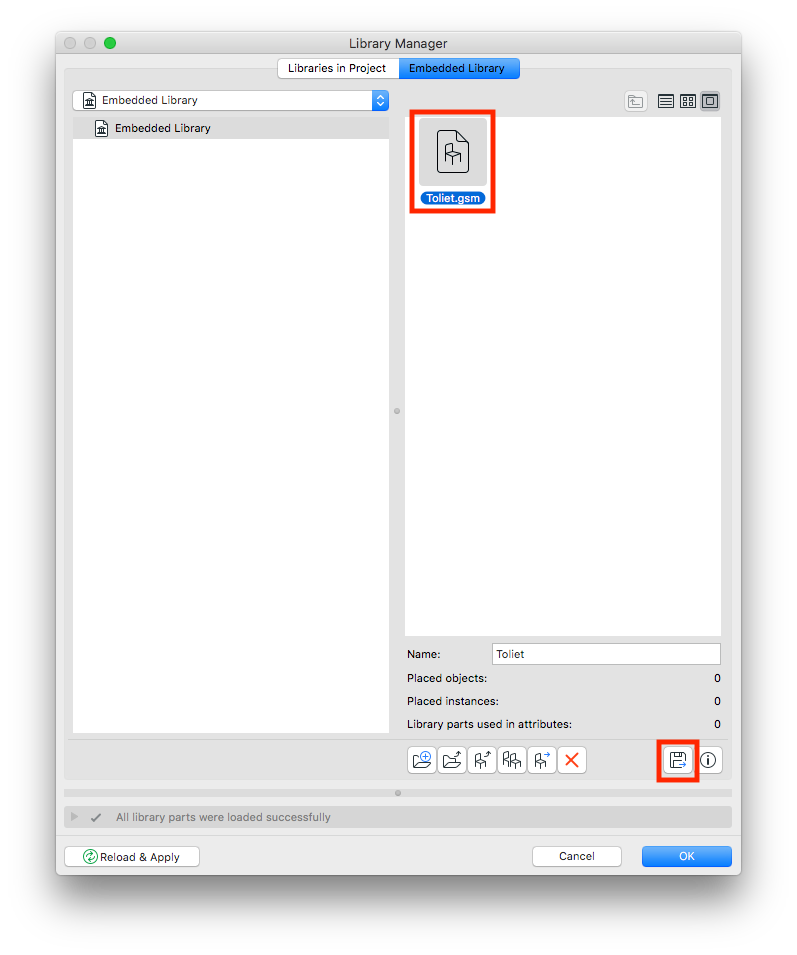

3. Select the content to export and click on the Export button.

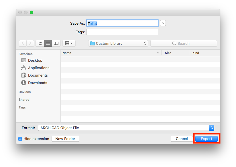

4. Choose a location to save the content and click Export.
